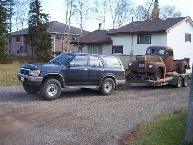

no problem if only 2 thousand pounds. I had a factory hitch rated for 7K lbs I think,,it was a heavy piece! Towed my OT truck back from Minnesota and pulled my 17' boat regularly with this old 4runner. 3L auto. NO issues ever.. Not sure how the newer suspensions were but toyotas always soft in the rear...
