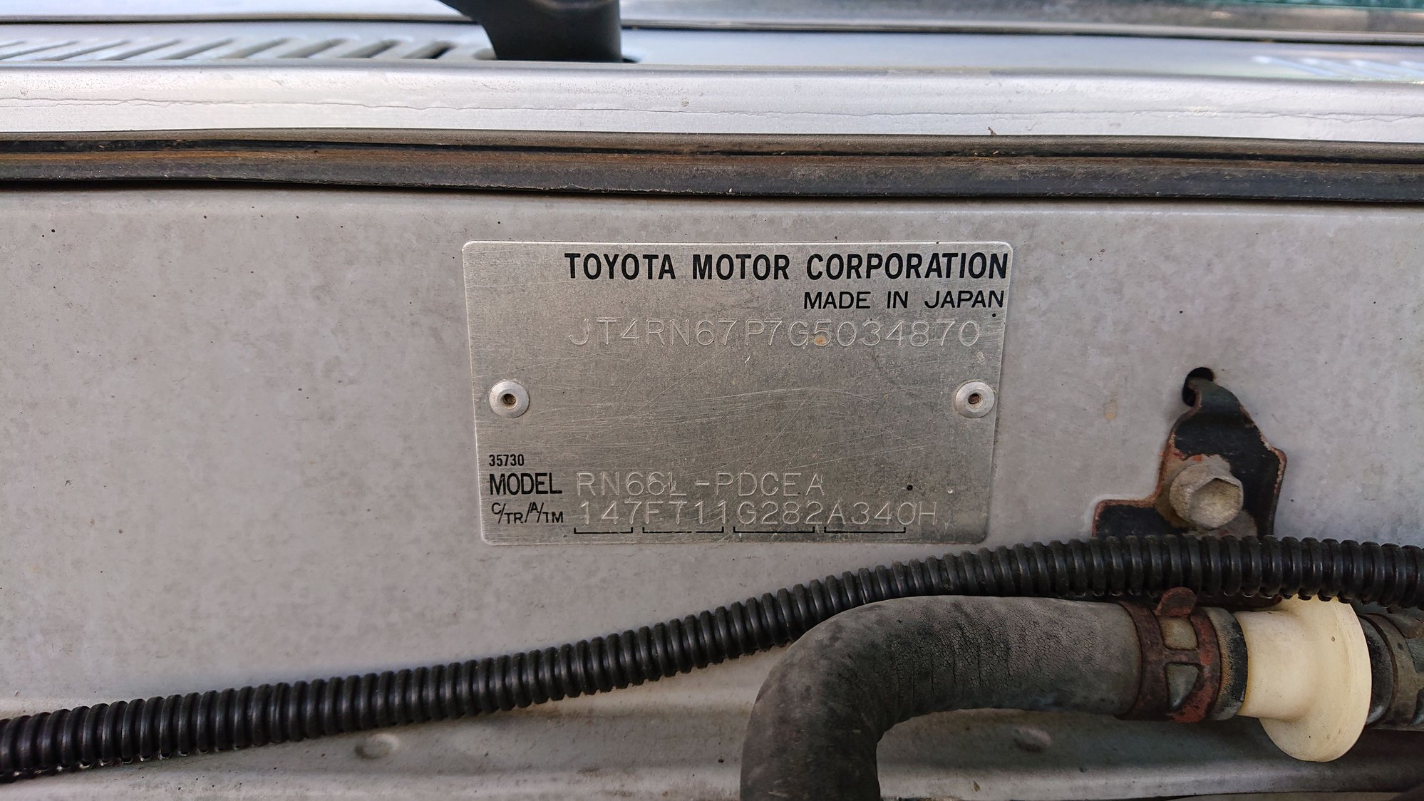

I have an oddball truck (I think) which has me confused about which torque converter is correct for the intended application. It's a completely stock 1986 4x4 xtra cab pickup with a 2.4L 22R-E factory-mounted to a A340H auto-transmission. According to the Aisin transmission wiki, the A340H transmission was installed in Toyota's 1988-1995 Pickups and 4runners but only with the 3.0L 3VZ-E V6 engine. I don't know how one ended up in my truck from the factory back in 1986 but it's there and they stamped it onto the firewall plate (see pic below). The '85-'95 2.4L 22R-E should have the A340F transmission if it's an automatic, which is exactly the same as the A340H except the shift selector linkage is mounted 90-degrees offset (F is on top and H is on passenger side), the H shares fluid with the transfer case, and the H is a bit more beefy, however they both can use the same torque converter but they're listed with different stall speeds.

So which one is a 2.4L with a A340H supposed to use? I think it should use the stock stall speed TC based on the size of the engine it's mounted on considering the transmission gears are exactly the same. Does this sound logical?
