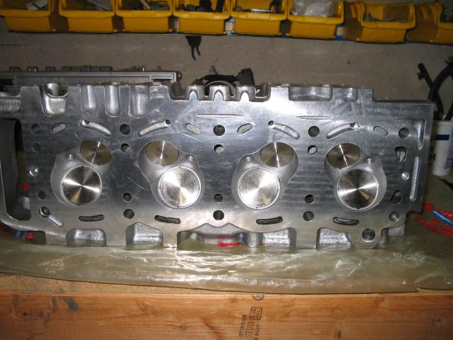

DaveInDenver's Avatar
Joined: Apr 2005
Posts: 313
From: Not Denver
Originally Posted by AH64ID
Because the timing chain cover bolts to the head and has a dowel that the head centers on. So you have to loosen the head bolts, which means any decent mechanic will pull the head and replace the gasket.
The two centering dowels are both in the block. There is a bolt that goes through the front of the head into the timing cover, though. You can see the front dowel in the picture of the block, it's behind the timing parts. The other picture shows both holes in the bottom of the head for the locating dowels.
To do just the timing stuff, you don't have to touch the head bolts, although the head gasket is the seal between the head and timing cover. If you are careful not to tear the HG when you remove the timing cover, then really you don't have to pull the head at all. Some people don't even pull the pan, but my feeling is that either the head or the pan should come off to have a decent chance at getting the timing cover to not leak oil. I prefer the pan to come off so that I can clean it and the oil pump pickup and so if you take a little time when you take the timing cover off, you can dab some RTV along the top of the cover where it seals against the HG and at the corners where the block/head/timing cover come together and it'll work fine.
