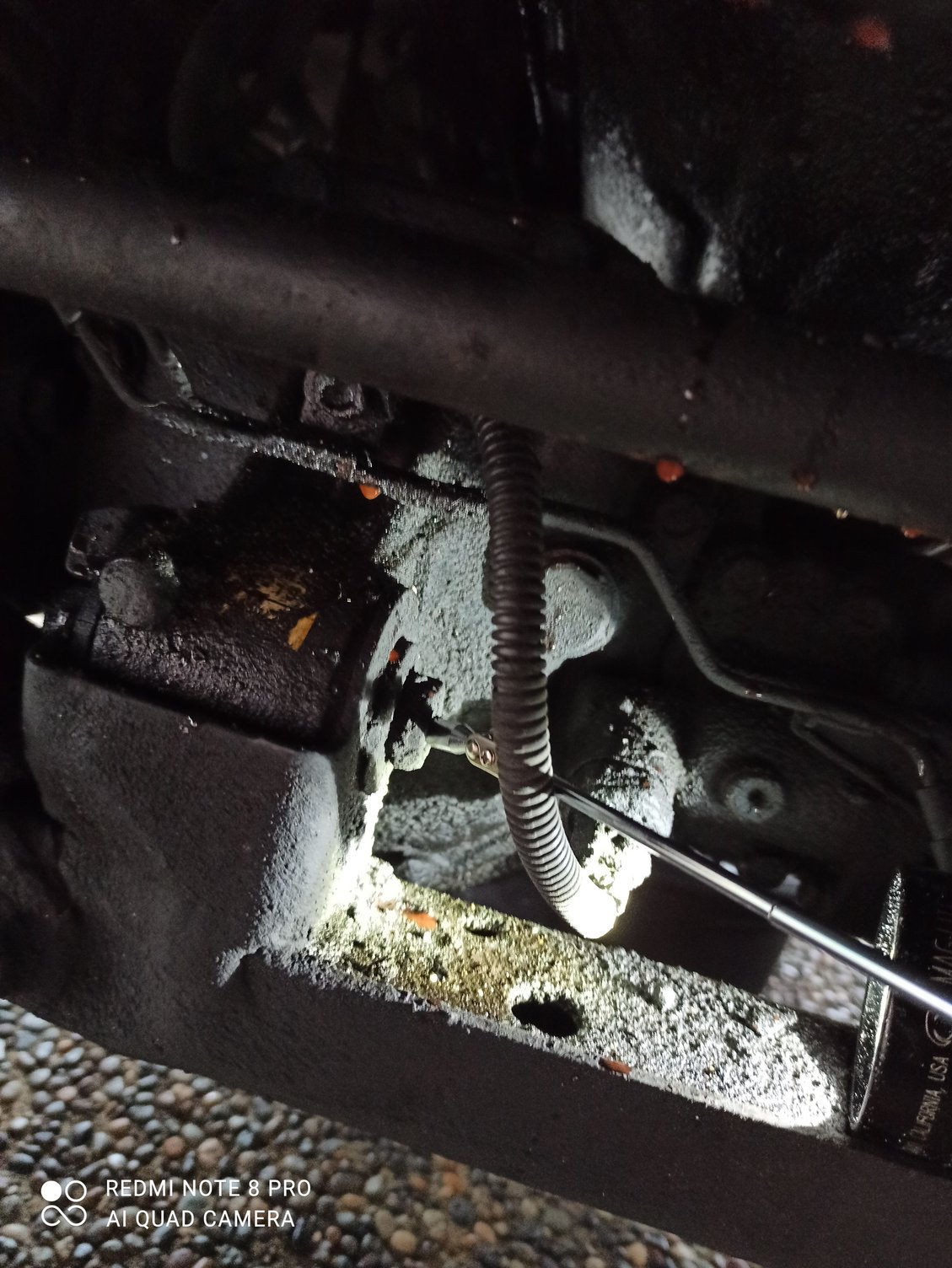

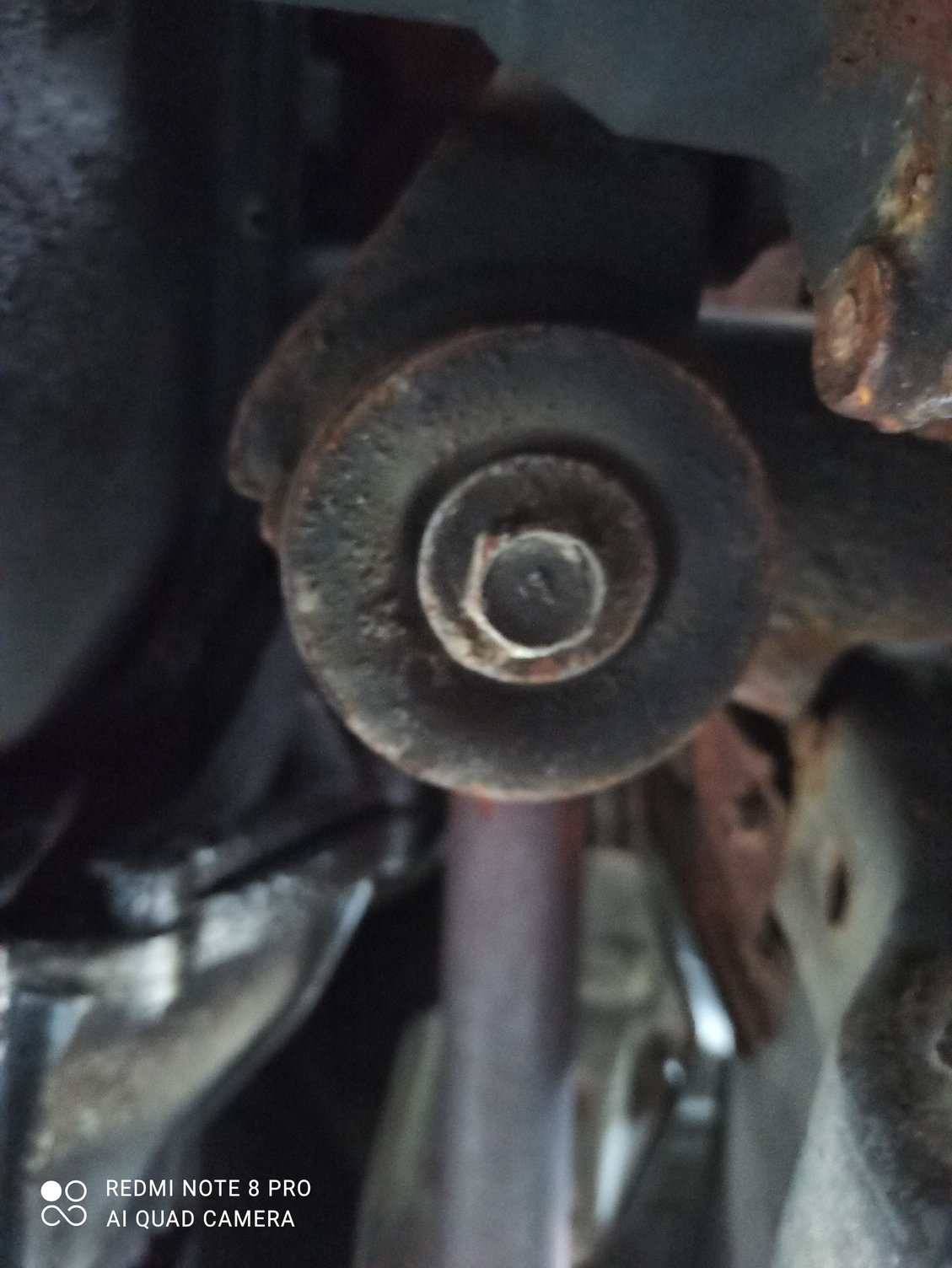

I have read that you can remove the oil pan if you loosen a 'front' horizontal bolt on differential and remove 2 bolts at the back. Then I guess the differential can swing down somehow (i suppose either in a backwards or forwards motion). Can anyone confirm for me that this would work and that these bolts in the pictures (the front one and one from the back) are actually the correct bolts to be loosening and removing?
the horizontal bolt at front of differential to loosen? (pointing with pointer)
would this be the drivers side bolt at back of differential to remove? (there would be another one just like it towards the passengers side)

You'll probably find it easier to unbolt the front differential crossmember from the frame also. You can leave the axles and driveshaft connected. The differential will then drop down a few inches and hang from these. Since you have ADD, you may have more complications with vacuum lines, hoses, and clearance. When I did this I still couldn't get the oil pan out without removing the oil pickup tube from the block. Then when putting it back together, I had to put the bead of RTV on the pan, lay the oil pickup in the pan, move the whole thing into position, try to install the oil pickup through a tiny gap between the pan and block while not messing up the bead of RTV and working around the front diff, and then bolt the pan on. I wouldn't do it that way again. I'd leave the pan installed if possible.

Front differential crossmember - how can i identify that one? Too late for me to leave pan installed - I have already removed 15 of the 18 or so bolts.

I was able to jack up my 87 4runner and put jack stands under the frame.
remove the bolts you have pictured
The bracket needed some serious persuasion to get it to drop out.
I also dropped the torsion bar just 4 bolts
PRACTICE a few " dry runs" putting the oil pan on.
If you do it just right you can get it back on with the gasket sealer on it.
I also had a spotter and extra set of hands to help steady and guide it into place. WITH the oil pickup in place.
I also had to cut the upper corners of the diff cross member to get it back in...
I used the jack to lift it into place.

Ok, I have come to the point of trying to drop this differential so as to allow for the removal/replacement of the oil pan. Actually, even before dropping the differential I have managed to remove 17 of the 18 pan bolts. Anyways, based on what I have been advised here (as well as watching a few videos) it seems that I must remove those two bolts behind the differential that I provided a picture of earlier (they are 19mm) and also remove that bar that runs across the front and under the differential (two 17mm bolts on each side) and then perhaps I also need to loosen (perhaps not remove) the one bolt that the differential is mounted with at the front (a 19mm). I have tried to crack all of these bolts with by breaker bar with zero success so far (I have also sprayed on a little PBBlaster). I'm not sure how much more leverage I should endeavour to apply? Would an air ratchet with impact socket likely be necessary? I do not have one but I could perhaps borrow (or I have even considered buying one). If so, is my Ridgid 6 gal 150 psi compressor adequate? Beyond these 7 bolts I mentioned there are probably a few more if I want to drop those other bars on the passenger side. Any suggestions - should I continue to try and break loose these bolts with more leverage?

Unless they changed the design in later years, the crossmember in front of the front differential is held in with 4 bolts and 4 nuts. I believe the factory orientation is to have the bolt heads at the front and the nuts on the back. Sometimes when stuff is really stuck, you might have better luck turning the nut instead of the bolt. When you turn the bolt, you're also fighting any potential corrosion and friction between the shank of the bolt and the sleeve it's going through. I don't know if you have a torch, but heating up the nut will help. Propane will take a very long time, MAP gas works pretty well for me. Oxy acetylene would work really fast. An impact wrench might work. Impact wrenches need high flow. A bigger hose and high flow fittings makes a big difference. If you have access, it wouldn't hurt to try. Careful with your terminology, an air ratchet is not the same as an impact wrench. An impact wrench makes huge torque by rotationally hammering the fastener. An air ratchet makes way less torque (still enough to twist your wrist if you're not careful), it's just faster than a ratchet by hand. If you haven't already tried, maybe get a long breaker bar, position it on the nuts so that pushing up will loosen the fastener, then use a jack underneath to push up on the end of the handle, effectively using the weight of the truck to push the wrench.

Thanks for the info and suggestions. Yes, on those crossmember bolts I was attempting to remove the nuts. As for the other bolts (at the back of the differential), I don't think i can get to the nut - was at the bolt head. I do have a propane torch so could give that a try. Yes, sorry I did use the incorrect term - should have said impact wrench (air). I do have a cordless Makita impact driver but I assume that isn't going to help me? If I heat up with propane torch I assume just apply heat directly to nut? As for those bolts in the back perhaps heat isn't the answer because cant get to the nut?
