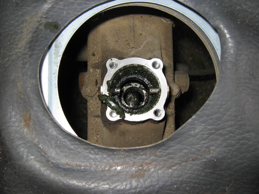

1988 pickup 2 wd 5 speed W55 transmission.
I looked at my seat and it is just a flat rubber washer. The other seats I have seen look like a bowl. Is my transmission weird or is it that my seat is not worn out?
This rubber washer has been remove in the first picture.

is it a washer? or is it tapered? I'm not sure what the w-55's is soposed to look like, but the w-56 is tapered. They usually split into atleast 2 parts, and it looked in mine like the 2 parts were made seperately and moulded together. Maybe you only have the bottom piece? the bottom of the 2 parts looks like a washer, and the top part is what is tapered.
Its interesting to see that the w-55 doesent seem to have the push and turn lockdown mechanism for the shift lever. It seems to just be bolted down is that correct?

It is a flat rubber washer - no taper. No push and turn lock - 4 bolts.
I have owned the 1988 since 1989. I replaced the clutch myself when I bought it so I doubt I lost any parts, and the original owner did not have it long enough to mess around with the transmission.
I have seen so many messages about this "seat" that falls apart that I thought I should check the condition since my truck is so old.
I do not have a seat like I have seen in the pictures. Maybe because I have a W55. At first I thought I was missing a part that was supposed to be on top of the rubber washer.

Still don't know for sure what my W55 is supposed to have. Just know all it had was a flat rubber washer. If there was a plastic seat on top of the washer then it ground into dust long ago.
Still need to rebuild or fix my transmission because a a bearing noise that is loudest in 5th gear. While searching on ebay for a transmission I found this.
http://cgi.ebay.com/ebaymotors/ws/eB...213929466&rd=1
This states that you have 2 shifter seats OR a spring. I have a spring and a rubber "seat", so this just confuses me more.
If my W55 is missing something then I would have never known. My transmission shifts fine and there is no slop. If it shifted differently when I bought it then I don't remember since it has been 19 years.

My mystery has been solved.
My transmission is being rebuilt by Auto Gears in Santa Clara, near where I live. Owned by Manjit and his son. They work on Toyotas.
For the past 2 years I have had a noisy 5th gear bearing. I told Manjit to take my transmission apart and put in a rebuild kit. I mentioned this plastic seat/rubber washer thing to him.
Manjit called me when the transmission was apart so I could look.
My truck did have a plastic seat in the olden days but it had broken apart and fell into the transmission. The oem plastic seat is bonded to the rubber washer at the bottom of the seat. That is why I could only see the washer - the plastic seat had broken apart and fell into the transmission leaving the rubber washer under it behind.
Here is the new plastic seat/rubber washer he is going to put in. The rubber washer is needed because it compresses a bit and you can then slide the unit under the 2 pins. Marlin's plastic seat is thicker to make up for the lack of the washer. But since plastic does not compress Marlin machines 2 grooves so you can slide the seat under the 2 pins.
