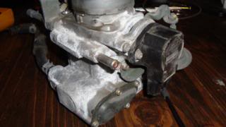

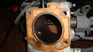

This is a spin off of my stalling thread. Went to a local pull-a-part yard and found a Thottle Body Assembly with the attached/incorporated Idle Air Control Valve from a 92 3.0 4runner. It seemed to be in realitively good condition. It was relatively easy to remove once you understand what connections go where and how to unhook the throttle cables.
Removal was simple enough, disconnect the control cables, remove the coolant hose lines, fuel line, vacuum hose lines and then 4 bolts.
Now my question is just exactly where is the Idle air control valve? I identified the side vents in the throttle body as the ports for the bypass but I read in some other threads about the idle adjusting screw. I can't seem to locate it. anyway, here are the pics of the TBA

What is the best solvent/cleaner to use in preparing this for installation? What should I be looking for in trying to test this unit for proper operation? I know I am going to have to go to Toyota to get the TBA gasket. Just wanting to know things I should be aware of from those of you who have replaced their TBA. Thanks again for any and all comments

The only issue I can see you running into would be if you didn't remove the TPS beforehand. Of course, carb or TB cleaner could hurt that.
If you want to test it before you put it on the vehicle, warm it up in a pot of water with just enough water to submerge the valve portion. The valve should close making it impossible to blow air through the IAC valve ports. (Ports are illustrated in the link I posted in the other thread) The valve is on the bottom of the TB. You can see the black cover with the small screws. Inside there is the valve. You'll want to remove the throttle dampener, dashpot, and TPS beforehand.
The idle bypass screw is the only large flathead srew on the TB. Located on the side where the throttle linkage is.
