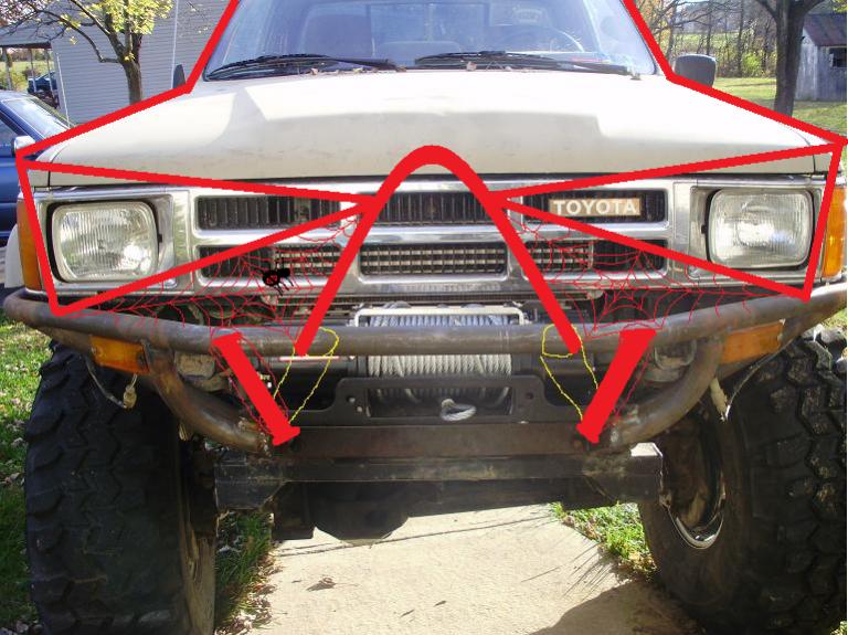

Started my bumper build on the Rat TuRD today. Didn't start bending the main piece up front untill it was dark out. Sucks bending with a flashlight!!! I'm kind of happy with it so far, especially for being my first one.
The home built winch mounting plate.
right front.
left front.
made with 1 5/8" Cromoly 4130 .083 wall.
It's not finished yet though, need to add a brace on each side from the main tube below the marker light to the winch plate, and weld on some tabs for the turnsignal lights, clean it up and paint. I'ts pulled back off till I can finish it up.

opinions needed please!!!
Sorry, new to microsoft paint but did my best. I just need some oppinions. I want to throw 1 more set of braces on from the winch plate to the main hoop but i don't know if i should put them in the red position or the yellow position. red would be the strongest because it goes to the bend right? but yellow would probably help offer a little more protection for the winch and intercooler. Don't say both because overkill looks tacky imop.
Old Nov 4, 2009 | 09:03 AM
Teuf's Avatar
Posts: 5,592
Likes: 24
From: Dixon, Ca
i would do Yellow n make m join at top in center. And then one straight up between the yellow n red.
Old Nov 4, 2009 | 09:33 AM
camo31_10.50's Avatar
Joined: Aug 2007
Posts: 5,334
From: Vian, OK
i say put in the red tubes...then bring it up to make a grill guard or light bar type thing..lol
Old Nov 4, 2009 | 10:47 AM
peow130's Avatar
Joined: Sep 2008
Posts: 3,887
Likes: 16
From: Spokane, WA
i like my idea o.o
spiderwebs are pure aesthetic.

Old Nov 4, 2009 | 10:50 AM
theAuthority's Avatar
User Requested Ban
Joined: Sep 2009
Posts: 1,660
From: Lynnwood, WA
i like the cobwebs. I say do it.
Old Nov 4, 2009 | 10:51 AM
peow130's Avatar
Joined: Sep 2008
Posts: 3,887
Likes: 16
From: Spokane, WA
lol
everybody loves the metal spiderwebs.
and now it's overkill lol
Old Nov 4, 2009 | 10:53 AM
Jay351's Avatar
Joined: Feb 2007
Posts: 9,055
Likes: 10
Go with the redtubes, then bend some sheetmetal and bolt it to the front of the bumper, then you got your protection for your winch and such.
I would look into more frame reinforcing, it appears you welded right to the front of the original frame. I would put in some additional bracing that spans down the frame...
I have to do it for my bumper, I dont trust it for heavy winching...yet
Old Nov 4, 2009 | 11:41 AM
jimep's Avatar
Joined: Feb 2009
Posts: 212
From: Carlisle Pa
Thanks for all the input. I'll take u up on some of that advice. Here's kind of what I want the finished product to look like, only a lot more fluent with the body lines.
If anybody has any better ideas I'd like to hear them before I start cutting and chopping more of the tubing. I'm always open for suggestions.

Hey man, get some triangles in that design.
Without them, you're going to have a really bad exo cage..
See, triangles don't flex and twist like squares or rectangles do.
