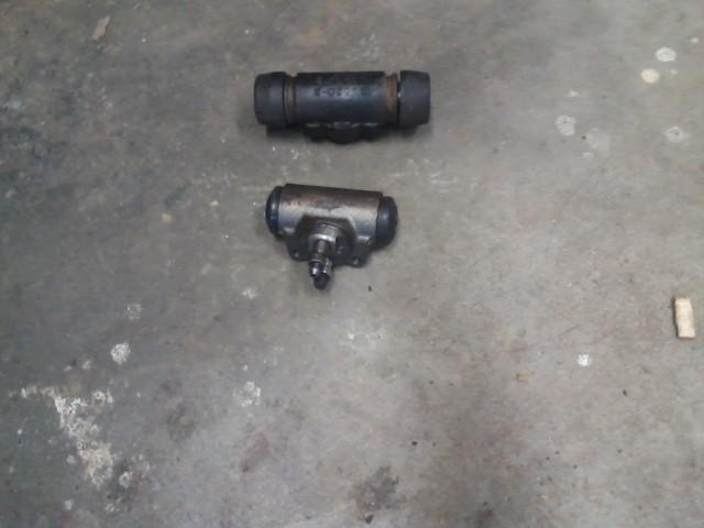

What year truck do you have? 84-88 trucks use different wheel cylinders on the rear. Some use a short cylinder and some use a long cylinder. I made the mistake of putting a short cylinder when I should of used a long cylinder and lost rear brakes.
The picture below shows the difference in the housing. Top is longer housing and the bottom is a shorter housing. May not be able to see it in the picture to well but make sure you get the correct wheel cylinder. Trucks of the same generation do use different wheel cylinders. Pistons inside the housing are different length.
