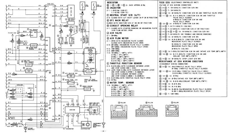

I believe it to be one of two wires that goes to the ecu. either the green/red stripe (speed signal) or the green with blue stripe (speed sensor ground). The colours point to the ground wire but I'm not sure that makes sense.
here is a schematic for the 80s ecu. Not great at reading these. calling wiring gurus.
