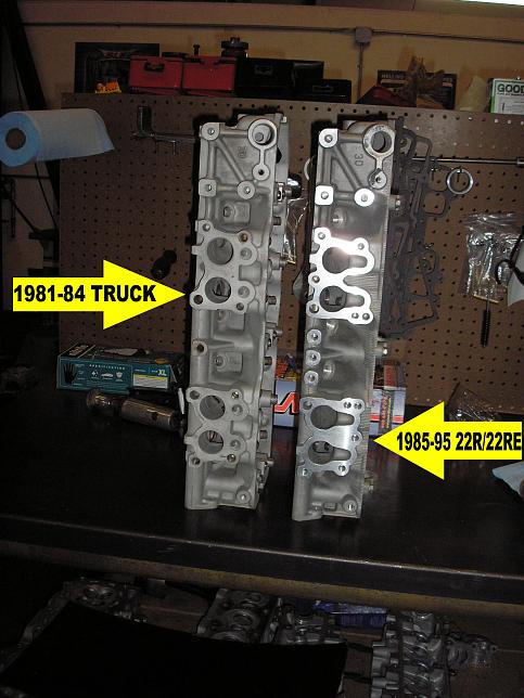

here is a difference between the pre and post style head:
old style head
new style head
Old Dec 17, 2010 | 08:19 PM

It seems that maybe another owner down the line could have done an engine swap for an older 22re, and when the guy I bought it off of had it rebuilt they could have put in the pistons for the newer 22re? The ones in mine are without a doubt the ones in the top pic, and those being paired with an older head could create issues I would imagine.
yes it definately would. and I guess that is plausible for someone doing a head swap and did not have any clue what the heck they were doing haha.
But I am not 100% sure if the old style head would bolt onto the new style or not. My gut says yes though.

Do you there any distinguishable marks on the exterior of the head and block that would tell me what I have?

the shape of the exhaust ports. and looks to be some extra bolt hols as well. And to me it kinda looks like the head around the spark plug holes are rounded on the 85-95 and squared off on the 81-84. see below photo.

No new and older heads are specific to tall deck or short deck blocks. I always get the two confused. The newer has the saturn (planet) like mark on it.
