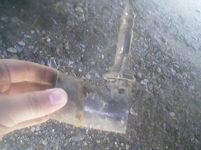

i will post pics of the o2 sensor, wen i get home.

here is a pick of the o2 sensor, it looks like it has ben apoxid on there.

Should look something like this and if you have been driving around with the o2 sensor (tip) exposed to the elements i.e. mud, snow, water road grime dangling under the truck you might want to replace it.

my truck has nothing like in that pick, that an yours is newer than mine. my o2 sensor line goes in under the cab and under the carpet.

You need to get a mount or have someone at a muffler shop fab something. Epoxy (as much as I love using it for a number of things) won't hold under all the contraction and expansion. JB Weld might. But, I've never used it for something like that. The sensor takes an awful lot of stress from vibration and what not. BTW, have you looked under the hood on the exhaust manifold for a sensor mount?

Your truck used to look like that...when they redid the exhaust they just cut the O2 sensor out.
