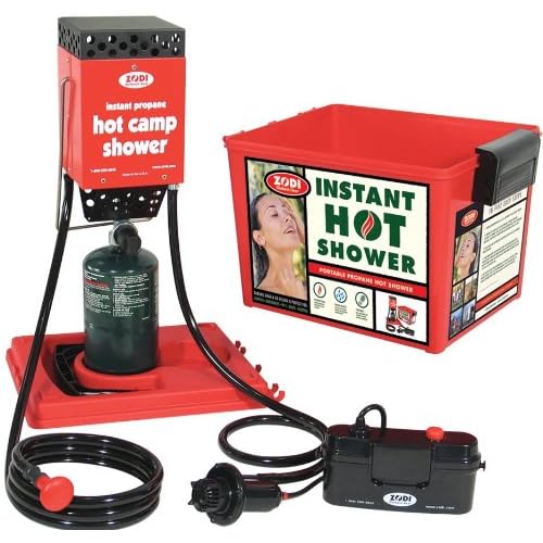

Originally Posted by Leviticus6432
I wonder if making a propane setup would be a cheeper route?
Too much involved IMO.
