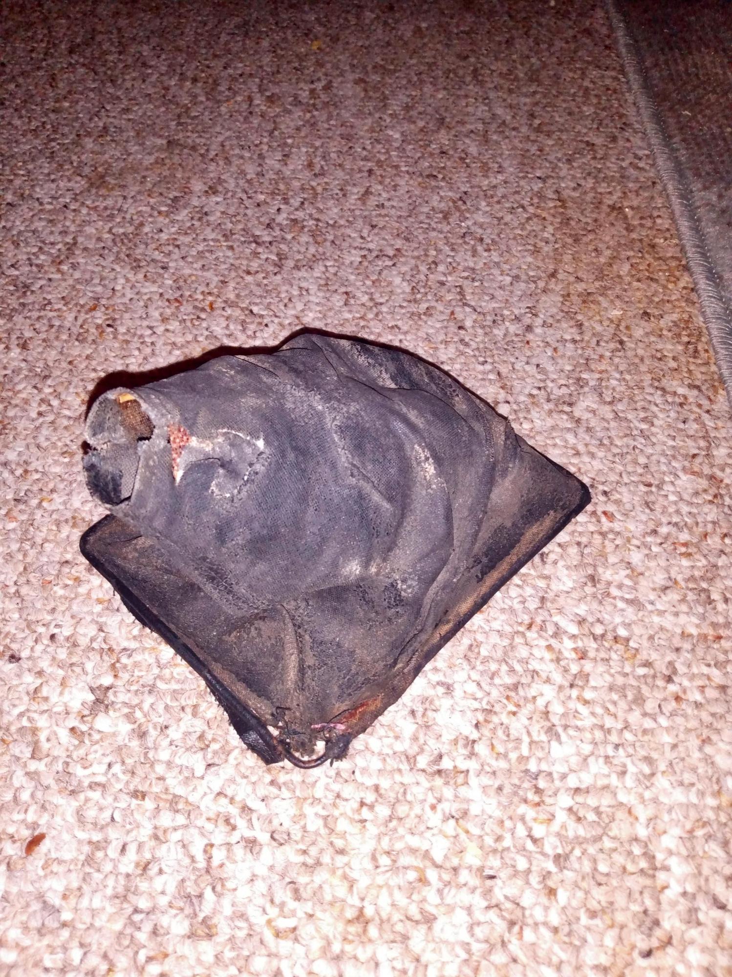

Just made a new interior shift lever boot to replace the OEM torn, full of holes, and crusty one. Had to make a pattern. Turned out better than I expected.
