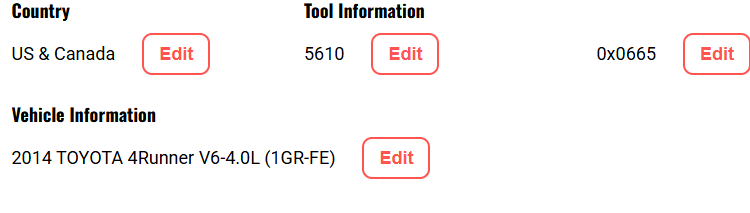

The 5610 V3 is primarily an OBD2 tool, not OBD1. To read OBD1, you need the OBD1 extension cable and Toyota adapter sold separately. It will only read and clear check engine codes for OBD1 vehicles. All the other features & functions only support OBD2 vehicles, depending on the year, make, model, and engine size of that vehicle. OBD1 vehicles are typically 1982-1995, however, some 1993-1995 Toyota Vehicles are OBD2 certified.
https://www.innova.com/pages/coverage.
Make sure to select 0x0665 in Tool ID box for V3. The 5610 V3 is the newest version that has a lot more advanced service resets and calibrations. For example, Suspension Calibration, Injector Coding, Occupant Seat Sensor Calibration, TPMS Relearn, and more.

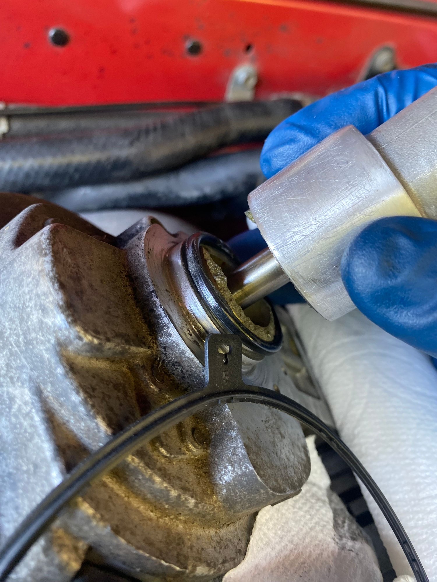

I bought a 1989 1st gen 4runner with the v6 about 3 years ago now. When I first got it, the thing ran pretty well, the usual oil leaking head gaskets and some troublesome cold starts. But once it was warm it was all good. Problems started months later when I decided to replace injector plugs on the main engine wiring harness. That went smoothly but after getting it all back together I had somehow begun getting the sudden loss of ignition once it warmed up.
So now that the truck had good wires going to everything, obviously it was going to throw me a massive curveball like that. The basic just of it was that it would cold start great especially after cleaning fuel injectors; but once it got to operating temperature it fully cut all electrical signal to the injectors.
I started by actually getting on this forum where people led me to the FSM. There I found the circuits and procedures I would need to chase down my ignition problems.
First thing that was wrong was in the air flow meter on the airbox. One of the contacts inside had snapped and was bouncing around. After soldering it back together, cleaning the sweeping contacts, and putting the lid back on; I still couldn’t get ignition after being warm but the truck ran much smoother.
After trying the coil and igniter, both of which were fine, I was onto was the distributor where I eventually found my problem. Someone at some point must have dropped it (pic below) and broken a contact inside. It also snapped the stem that goes into the motor which I haven’t seen before. Maybe it just took time for it to finally come free and drop signal from the hot circuit. It wouldn’t keep the correct voltages after being warmed up. Cold circuit was just fine.
after everything, a replacement distributor was all I needed and I had to say I was pretty lucky it wasn’t more of a chase
my favorite thing about these trucks are how simple things are. If you have the patience and stay organized you can and will solve any problem that comes at you. Just takes a little thinking.
broken distributor, definitely not working.
