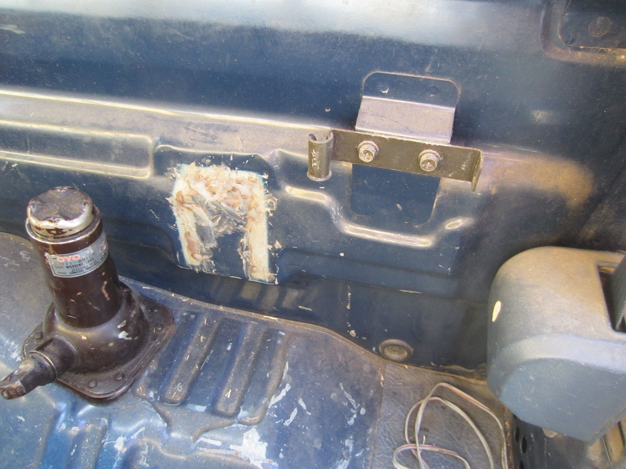

Looks like someone decided to grind the holder out in your pic……
in your first pic your jack is right below where the holder used to be, you put the jack under it and twist the jack to pressure hold it so it’s secure…..

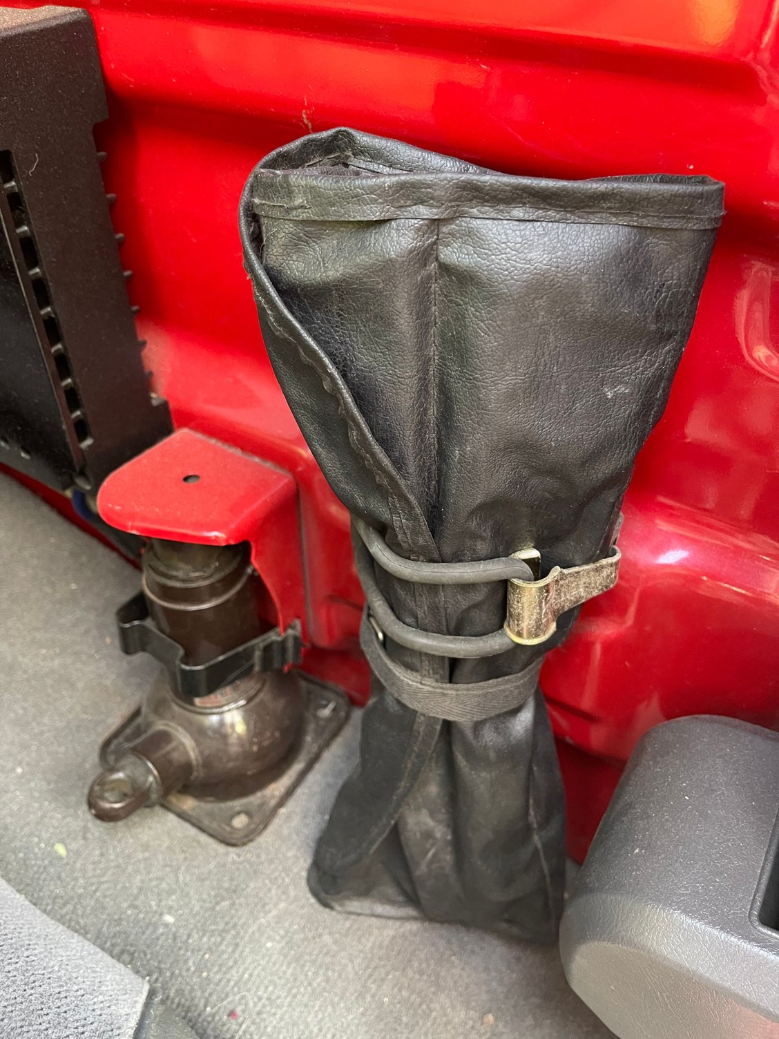

2ToyGuy... Thanks! Yes a picture or two please, just for my info. I carry a 25" harbor freight breaker with cheapo impact socket, and scissors screw jack if I go some where I think I might need it. I guess I'll just fasten a strap tiedown over the jack just to keep it from rattling and slow it down if I should get into some heavy negative g's.

Old Jun 11, 2022 | 07:50 PM
JJ'89's Avatar
Joined: Aug 2007
Posts: 356
Likes: 56
From: Fresno
Thank you very much!
