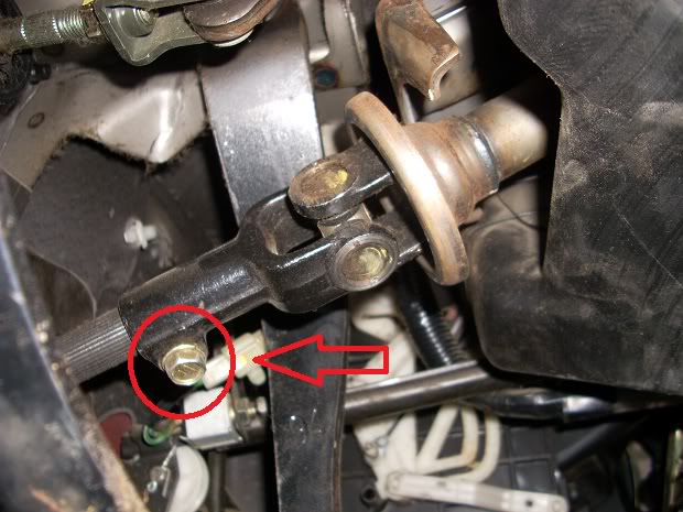

I too need to replace the seal and I found a how too with 80 series land cruisers on another forum, but they have different set up than the trucks. Did a search on the 1986-95 4runner & Truck and this thread is all I found.
Do I undo the bolt under the dash (Arrow pointing too 1st pic) AND do I undo the single bolt next to steering box (arrow pointing too) and they will come apart by sliding the shaft one way or the other?
OR do I take apart the rag joint (arrow pointing too) just above that bolt and the bolt under the dash? which is the best way to do it. I will mark and index the shafts attachment points with a sharpie before dis-assembly.

Pretty self explanatory...disconnect the shaft and slide it out of the firewall.

I did it!!!! got the dust seal installed, and was not that hard at all I thought it would be. Here is the procedure from start to finish.
1st is to have front wheels straight and then bungee the steering wheel, hooked the hook under the seat.
2nd is to unbolt the bolt connecting the join to the steering shaft after marking it with a sharpie.
