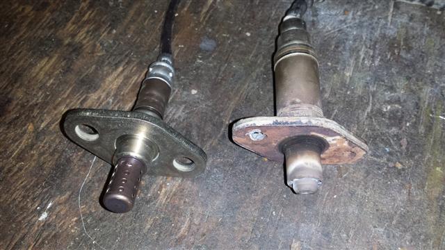

Removed 02 sensor and "sniffer dome " is dented, don't know if it matters. Ordered a new denso. The 1991 was different.

Installed new Denso 02 sensor. It made an improvement but still have the 1800rpm "stumble" ...just not as bad.
Can't see any arcing under hood btw.

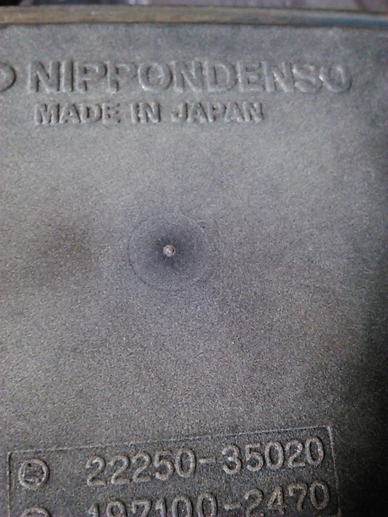

Next question, can I swap the 1991 MAF with the 1992 ?

On the top of the AFM in the black part, you will see the part number. Compare the two. On the earlier generation it is part number 22250-35020. You could also see if the part number is the same on toyotapartseast.com

The part numbers matched so I swapped them. It made another improvement in the low rpm range...but I still notice (some) hesitation @ 1800-2000rpm 2nd to 3rd gear change.
