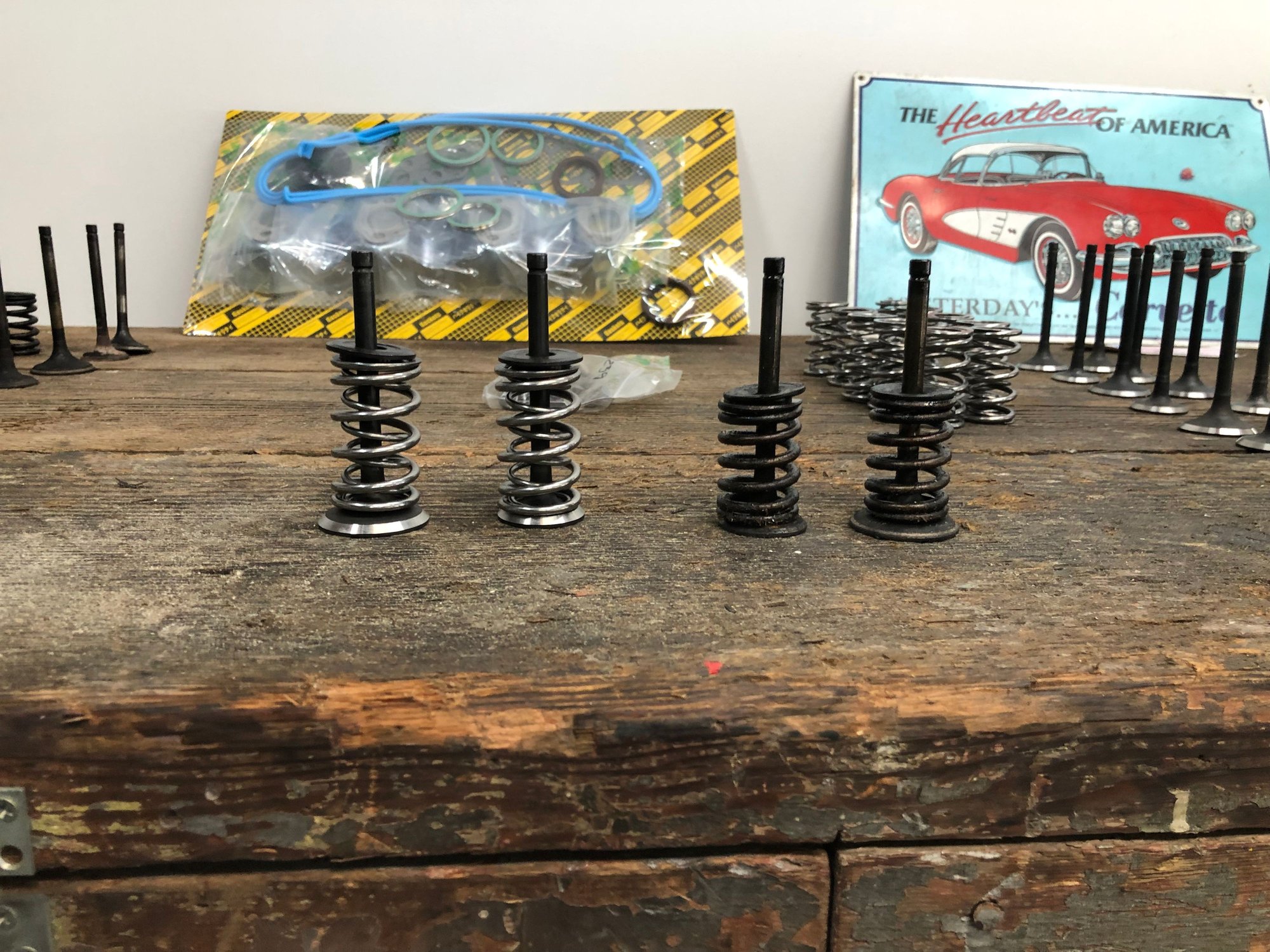

I have new LCE dual springs on my 3.0. I’m wondering about running the valves 0.01 over spec to get more lift out of the valves. Anyone ever do this?
