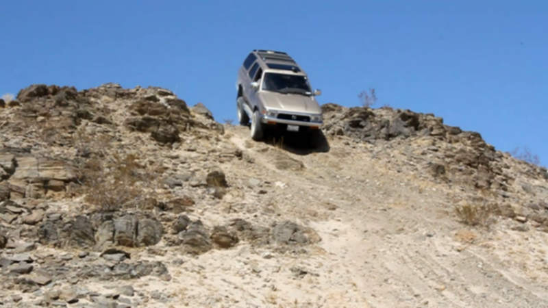

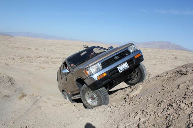

Here's some pics of the last desert trip.
Attached Thumbnails Rough Road Fabrication 4Runner Mid Travel Setup-mvi_3893.mov_snapshot_00.25_-2012.03.19_23.38.00-11.jpg   Rough Road Fabrication 4Runner Mid Travel Setup-img_3832.jpg   Rough Road Fabrication 4Runner Mid Travel Setup-img_3896licenseplate.jpg

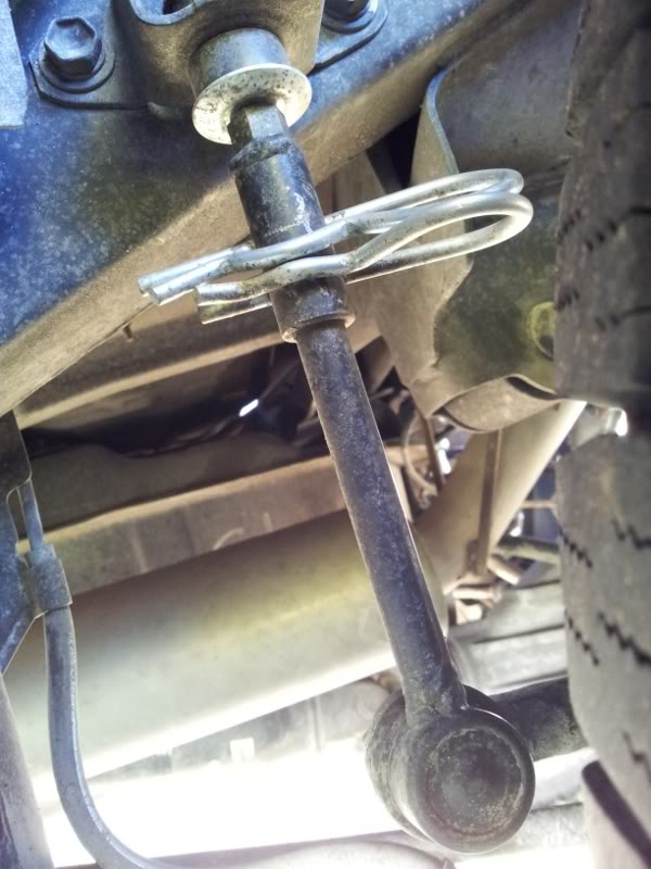

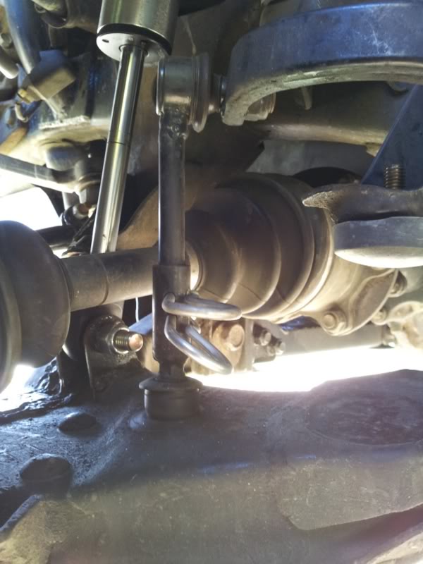

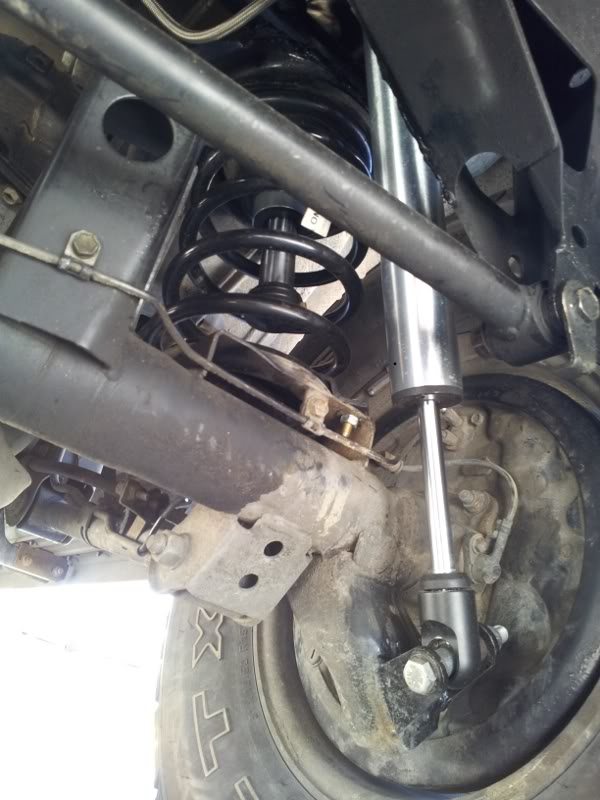

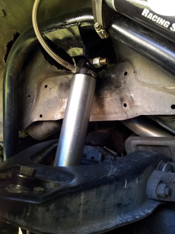

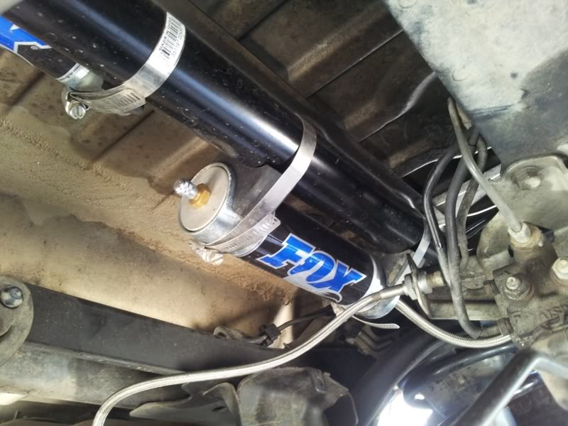

By the way.. Looks like Rough Road posted the uniball kits and idler arms.
http://www.roughroadfabrication.com/Parts.html
More Updates...

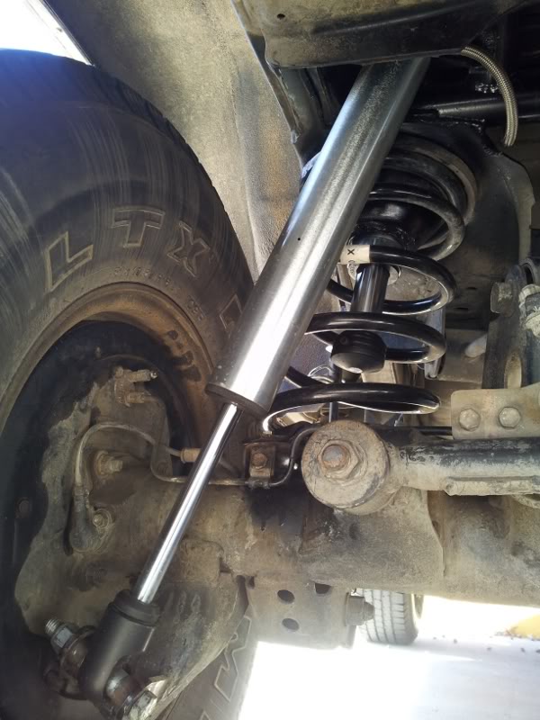

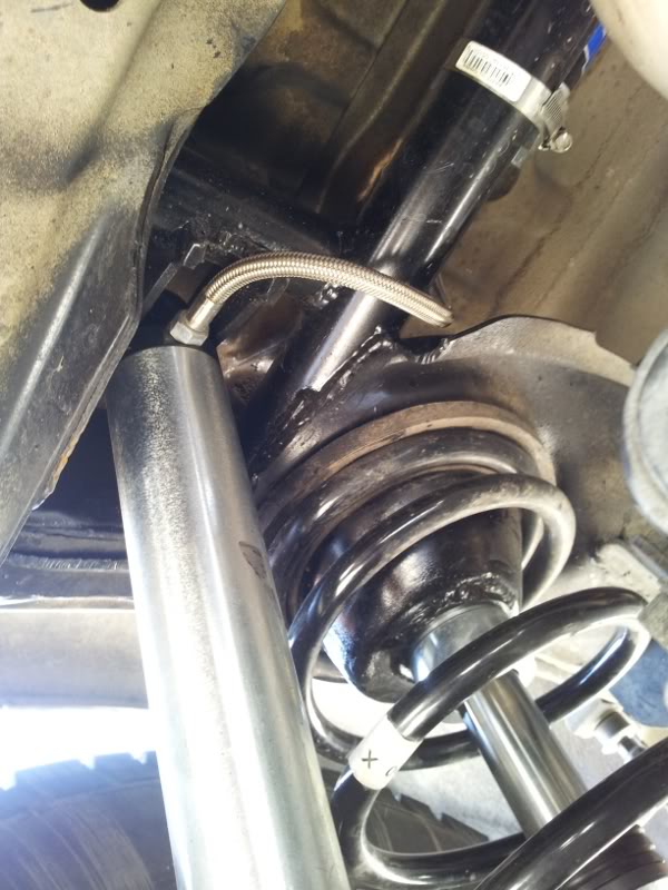

A little dusty...
New front tabs for 2.0x8's
Front quick disconnects
Rear quick disconnects
I mentioned earlier that hydro bumps were installed. They are actually Fox 3inch air bumps.. Sorry about that.
