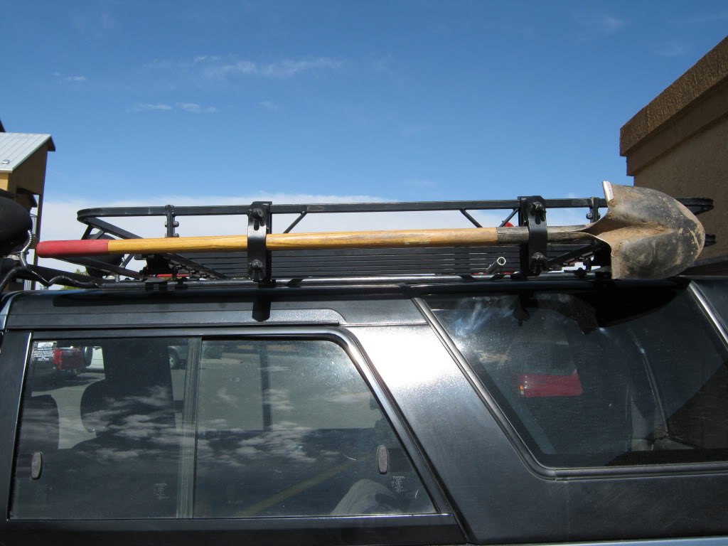

Shovel mount.

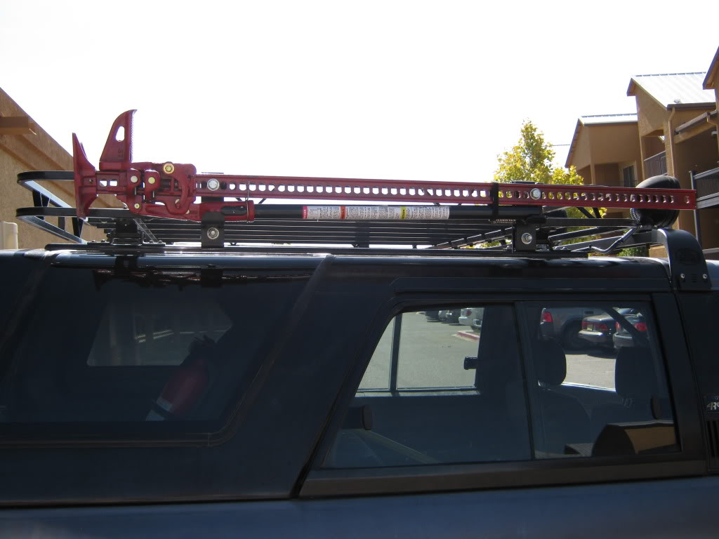

Hi lift mount.

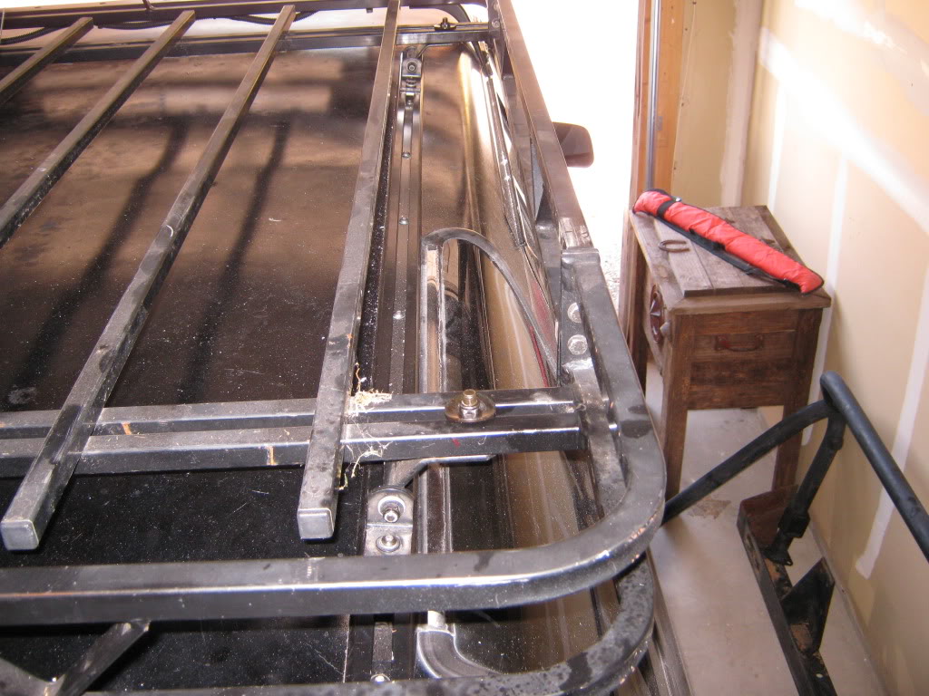

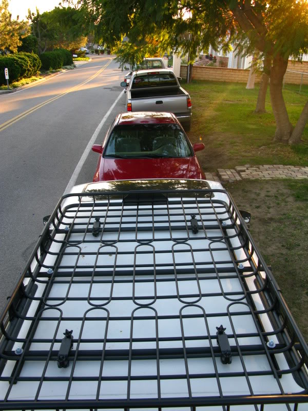

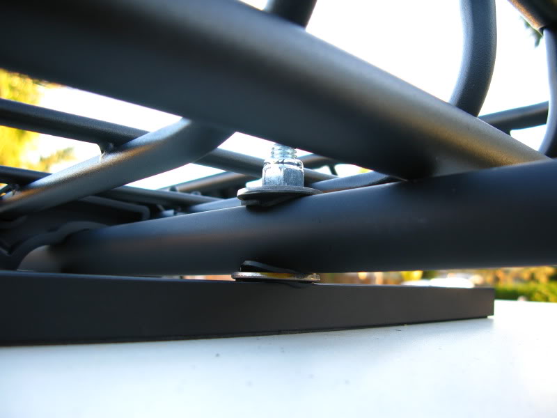

I finally got a few pics of the rack and mounting. The rack was a cheap one I found on Amazon. $200 shipped, including the extension. It's made to just screw together where the pieces meet, but I welded it instead and it's MUCH more solid that way. And I think it's the perfect size for the 4runner. Here's a link to the main basket... http://www.amazon.com/gp/product/B00..._ya_oh_product
The crossbars I just made out of 1" round tubing. I don't remember the wall thickness, but they're plenty strong. And then I got some plastic endcaps for them.
For the crossbars I used stainless hardware with neoprene washers to reduce wear and such. And for the rack I just used the supplied bracketry.
It would have been nice if they included another pair of brackets for the middle section. I'll probably try to order a pair separately.

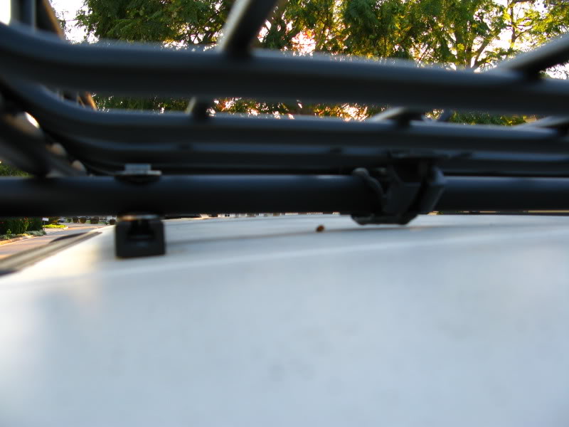

This one's a little out of focus, but I just wanted to show how nice and tight it is to the roof...
