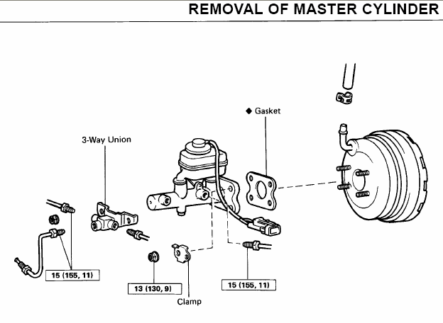

This gasket, as drawn in the FSM. Yes, I know, sometimes they are destroyed, and sometimes they are not. For anyone who has done this, I would appreciate knowing their experience.

When I replaced mine I got some gasket paper from kragen and made my own, no leaks in over a year.

Does that gasket actually keep the brake booster sealed? Seems like it just keeps the interior of the truck sealed from the engine compartment. When I did it I think I just made a gasket with some RTV.

With tax it was $2.29 at the dealer. After looking at the gasket I thought the same as 854x4, just get some paper and make my own.
I am going to do this today. It appears to be pretty simple, I think the only part that will take some trial and error will be the adjusting of the rod in the vacuum booster, but maybe it won't need adjusting.

When I did mine, I got lucky and it came out ok. I don't think it does a heck of a lot in there 'cause there shouldn't be any fluid coming out that end of the cylinder. If there is, I'd be rebuilding it....

It dosent seal fluid, it seals the vacuum in the booster from escaping.
