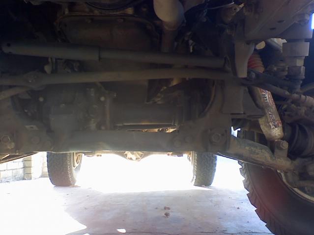

Here's a picture of the bent center link

nah, that's not bent . . . it's high clearance
