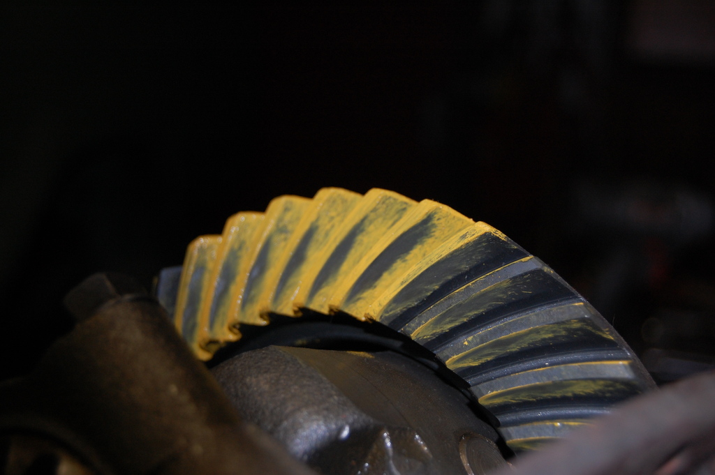

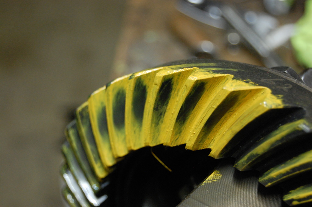

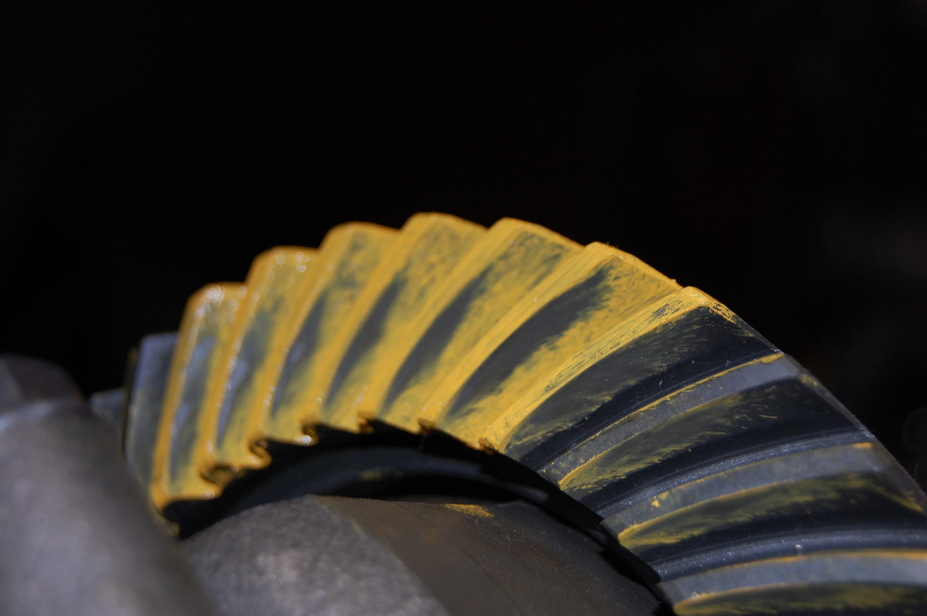

Well ZUK....you are the man! rotation smoothed out and my pattern is light years better. I went with .220 and here is what I got. I am at .007 backlash
I found it hard to photograph so I hope you can see it well enough.

Shallow....time to use the 240

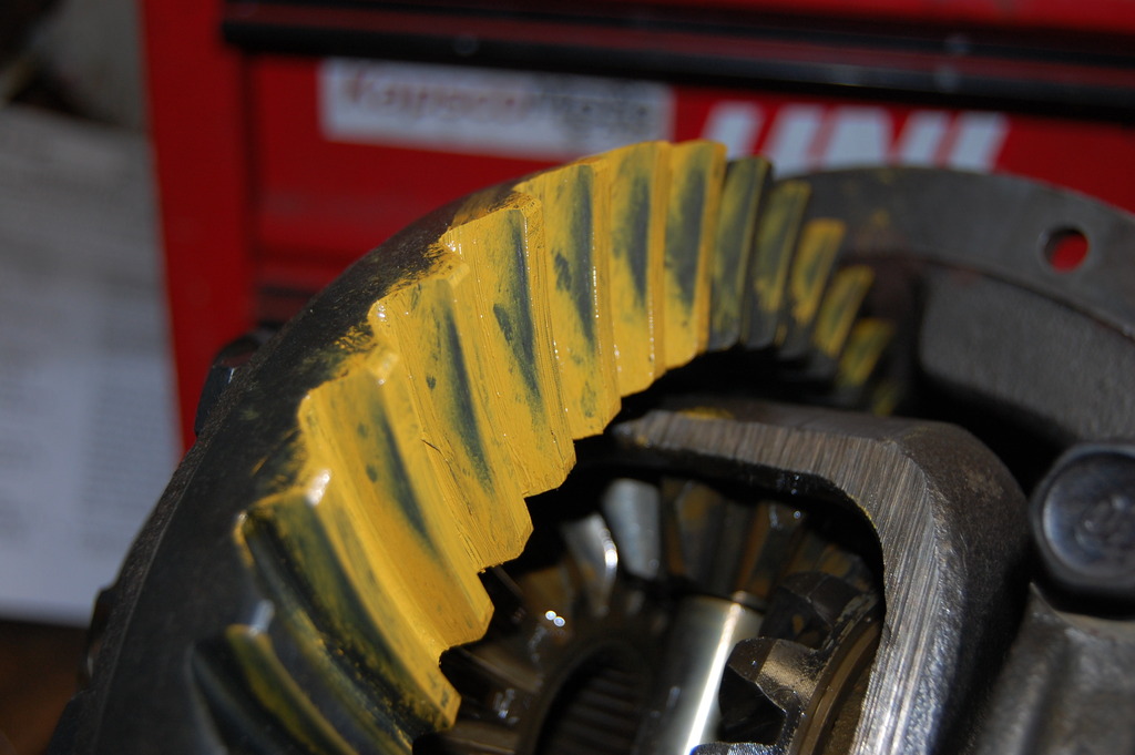

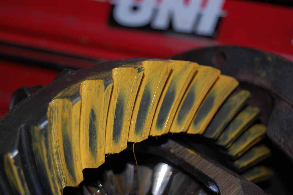

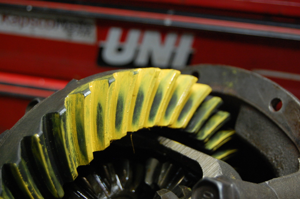

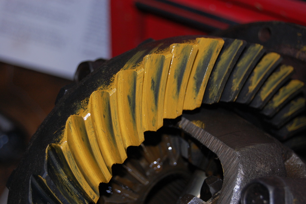

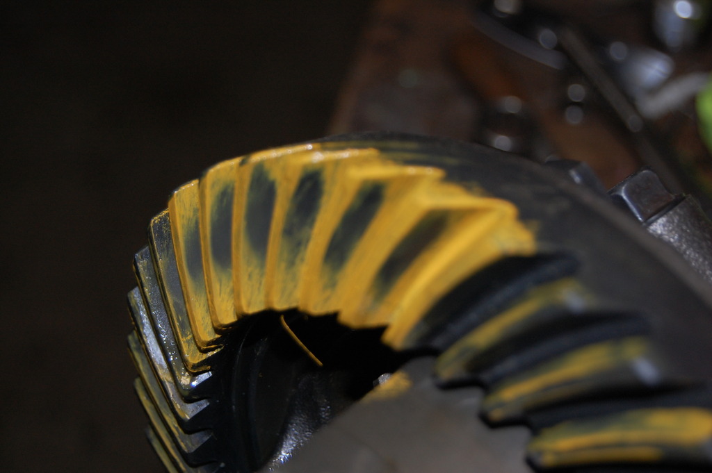

Ok, sorry for the delay! Here is what I have with .008 BL and .240 pinion shims. What do you think? I think it looks good....and I really don't want to press of the bearing another time. Also is it normal for the end of the pinion to come within a few thousands of the carrier? Im guessing its because I had to shim the pinion out so far.... do I need to do anything about that?

That's a beautiful pattern....don't touch it.
A few thou from hitting the carrier? That does not happen unless you have the thicker ARB case in there. Wouldn't be any different with the other "32307" bearing from the "A" kit and using a standard .080" shim......the correct thick bearing(32307) pushes the pinion exactly as close as you see it now. Does not change a thing. Did you actually put a feeler gauge in there and get a feel for how close it is? There can be an optical illusion going on there.

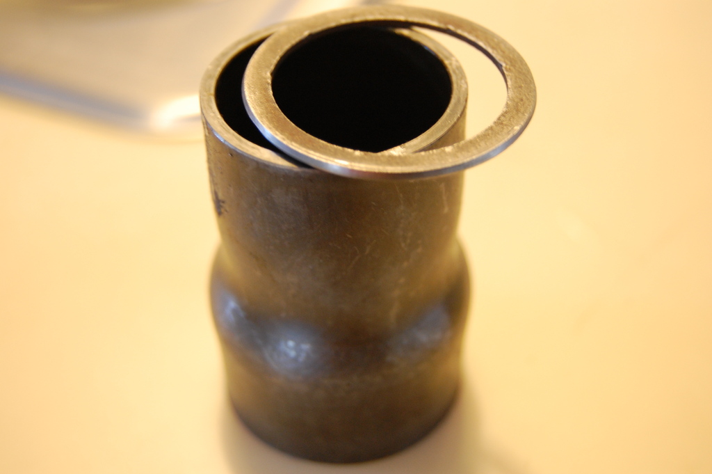

Here is a picture of the shim I made.... It brings my sleeve up to 2.440. thoughts?

This is the crush that came out of the rear by the way....the crush that came with this kit would be even shorter, even with the shim.

Looks good.
