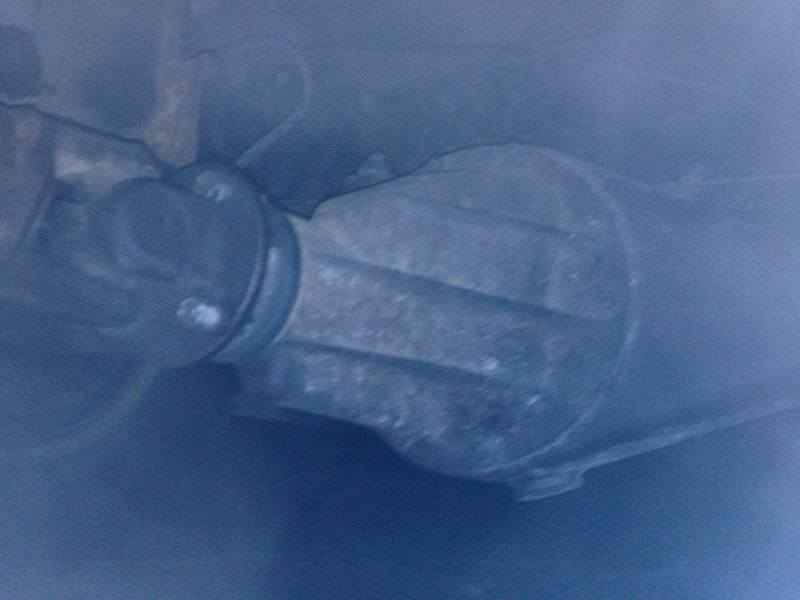

Two piece drive shaft? Mine did similar and it was the carrier bearing
Old Apr 24, 2013 | 10:59 PM
Jbranting's Avatar
Joined: Apr 2013
Posts: 22
From: Coeur d'Alene, ID
Looks line a solid axle to me? I took a pic, hope it posts so you can tell me
