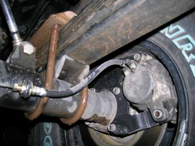

When first installing my kit, things looked askew until I cranked the lug nuts on to seat the rotor and compress the caliper piston enough. As for dimensions, Elvota, Yota, and bskey - you're right, the axle's width and twist can change the whole thing. I think my axle's torqued back some, and so I was barely able to get the upper caliper bolt in. Just barely cleared the springs.
You can see in this pic two things: the level of the caliper bolt with the leaf springs, and the reason that axle width precludes the placement of the brake line.
?action=view&current=AttachingDiscs005.jpg#%21oZZ2QQcurrentZZhttp%3A%2F%2Fs825.photo.jpg%26
I'll have to run it parallel the bracket and the springs:
Here's the overhead view:
Dang. I thought I was done with the grinder.
Do I need clips to keep the brake pads in place? The inner one has such a thing, but the outer pad floats and secures to nothing. It's just held loosely in place by the caliper body...

Before you break out the grinder...
Shouldn't your bleeder valve be higher than your brake line?
Old Nov 2, 2010 | 04:23 PM
  #50
drew303's Avatar
Joined: Dec 2006
Posts: 2,880
From: Olympia, WA
That caliper is upside down. The fitting is on the bottom bleeder ontop
Old Nov 2, 2010 | 04:31 PM
  #51
drew303's Avatar
Joined: Dec 2006
Posts: 2,880
From: Olympia, WA
I think you got the calipers in the wrong sides
Old Nov 2, 2010 | 05:12 PM
  #52
BigBluePile's Avatar
iTrader: (3)
Joined: Dec 2006
Posts: 15,192
Likes: 190
From: Sedro-Woolley, WA
Indeed.

Re. calipers backward
Thanks guys. Duh. Switched them up, bled the brakes, and just when I was thinking I was done and ready to see how the proportioning valve carried through, the new FJ80 master cylinder (from same prominent off-road shop in CA that messed up my axle bearing and seal kit order twice) failed. Leaking out the bottom. Can see the pinholes in the cheap metal seam on the bottom front end of it. Brake fluid everywhere - I originally thought it was from bleeding the MC. Not so. I'll save the sob story about how sad I am without my truck working for the company that's going to be sending me a new MC asap.

We'll never know what TruckeeToy said before he got the wambamhammer
anyway, your caliper doesnt look like my GM calipers. But heres how these particular ones should be installed

heck heres your caliper, same as elvotas pictured on the first page,
interesting...seems like it should be flipped. I'm confused how this bleeds?

Bleeder goes on top as air rises in fluid. Bleeder is on top in that pic.

Well yea i understand that but still a strange design how the inlet is above the bleeder. Maybe my "style" GM caliper was a later model?
IIRC the data used to order it was an 82 Montel Carlo front calipers thru NAPA.
