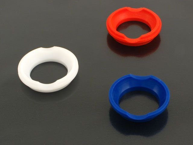

Did you change the shifter seats when having the transmission redone? It helped on my truck in the past. It's also a pretty easy thing to try before pulling the trans and tearing into it.
Marlin Crawler has "heavy duty" ones fort $13.
https://www.marlincrawler.com/product/heavy-duty-seats

Yes, I did change those also. Thanks
