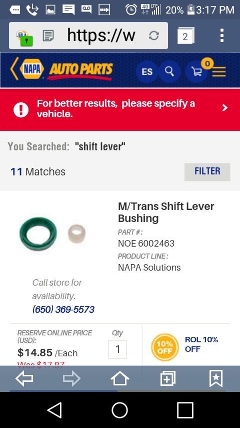

Working on my paw paws Toyota that I will be driving again after a break. Towards the last time I was driving it. The shift started to get sloppy then it got to where it wouldnt go into 5th then reverse.
It still goes 1-4 good but its got some play in it. Its never been rammed in gear so II'm hoping its not bent forks but its never had a shifter seat and bushing replacement so it needs it anyway.
I looked it up before but now I can not find the part # to tell NAPA. I know the Marlin Crawler is tougher but we're just wanting to get 5th and R back as quick as possible.
I found this. Is this all I need if not can someone please give me the part # of what I need? Thank you.

dang .. that looks like the one .. I'd try it !!

Well I would but they no longer carry it so im just going to order the marlin crawler one.
