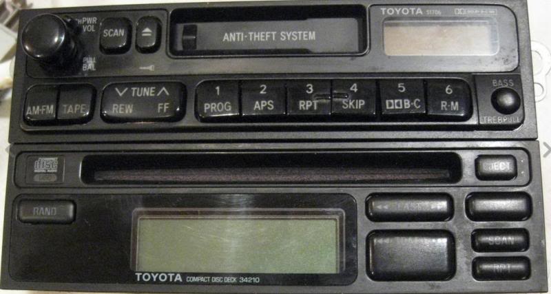

OK. Who has a '94 4Runner with the factory radio/CD deck? If you do my question is:
Do the buttons illuminate along with the LCD screens? If so, can you also adjust the dimming like the rest of the dash lights?
After many, many years of not having tunes in my rig, I happened to find a double-DIN stack factory radio/tape/CD along with the set of speakers ($55). Re-pinning the plug modules was no big deal thanks to the previous posts showing the pin-out and wire colors The set now resides in my pickup and sounds great.
Tested: My ILL 12+ wire shows voltage when the light switch is turned to the running and headlight position. I know the dimmer adjusts the ground-side of the two-wire dash light system. This wire is slotted in the "J" position as depicted in FLUBYUx2's post. The gray IGN 12+, and BTY 12+ are both functional. I'm going to double-check all wire vs. pin positions just because I'm doubting myself as I write this.
Problem: the buttons don't light up and the LCD screen lights turn off when the light switch is rotated to any "on" position.
Question: Are the buttons supposed to light up? Are there burned-out lamps behind the radio/tape/CD face plates?
My radio faceplate is slightly different from this one. Otherwise it's the same thing:
Let me know guys. Thanks.

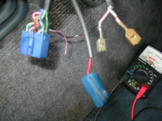

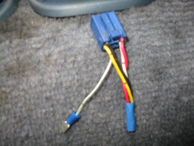

I got this figured out. On my original radio, there was no second set of speakers, so when I picked up this '94 double-DIN setup it didn't dawn on me to think about the smaller plug module on the back, which has the pin-outs for the second set of speakers. Low and behold, on that '94 second plug module there's a pin for a 12- ILL wire. I tested the single red/blk wire on my harness and learned that it is 12- and controlled by the dash dimmer. It was simple to solder a spade connector onto the wht/grn second plug module and connect the red/blk 12- to it. It makes sense now...the radio deck does not make a ground connection through the brackets. Since my dash lights are a two-wire system with the dimmer controlling the level of 12-, the radio deck(s) also needs a 12- connection; hence the wht/grn for the front/rear speaker setups and the red/blk front-only speaker setups. I suspect that that single plug module connected to my old radio in some manner years ago, and I forgot about that.

The second, smaller plug module on newer sound systems showing the left/right speaker pairs and the wht/grn 12- wire. This is position "O" on the diagram.
This pic shows the larger plug module on the left with left/right front speaker pairs, IGN, BTY, GND, 12- DIMMER in the middle, and on the right, the two leads for the cigarette lighter. NOTE: there are two unused power antenna leads...diagram leads "H," and "I."
Jeez. I hope this helps someone. I've got the radio deck out right now; going to check for any burned-out bulbs behind the face plates since it's daylight outside and I can't tell if the bulbs are on or not. I'll edit this portion based on what I find.

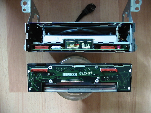

Unclip the CD face plate from the body. Remove the four small screws holding the circuit board. Underneath you'll find a single bulb with a green cover. (Sorry, I nuked the pic showing the bulb before re-installing the stereo back in the truck.)

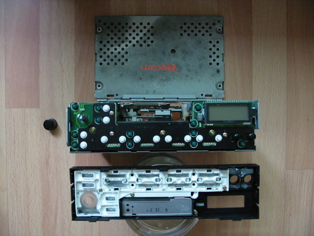

Pull the PWR/VOL knob straight off. Peel back the black tape from the face plate. Remove the top plate from the radio body. Carefully pry the clips holding the face plate to the body while gently pulling face plate away. Underneath you'll find 12 green-covered bulbs. These bulbs are modular...i.e, you remove them with a quarter-twist and pull them straight out. I'm not sure if the dealer/parts counter will carry these (doubt it.)
All my face plate bulbs appear to work, so no repair needed here.
