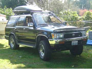

Nevermind....I see it under the advanced tab. Here's about the only picture I have of the Runner at this time. Of course, the boat hitched to the back isn't helping the look right now either I'll snap some before the work starts tomorrow.
Attached Thumbnails Pre-cranking front torsion bars on a 94 runner 3.0-runner.jpg

I installed the Downey HD springs about a year ago. The ride height increased by 2.5"... it was sagging quite a bit. (Looked like yours) I run 285's no problem with no torsion bar adjustment. I have been considering doing the same thing you are talking about with an alignment and the recall work. I went and talked to the service manager where I would be taking the 4runner and talked to him about the torsion adj. and the alignment. He said they are obligated to set the toe, but not necessarily the camber (which is thrown off by adjusting the t bars) in case the adj. bolts are frozen or something.
I am not going to chance it.
I just went and checked. My front still sits 3/8 of an inch higher. Check it out.
When I tow my 16' camper, the rear sags maybe 3/4 of an inch (if that). The springs are really, really stiff!
--Now if I could only find someone to weld my Stubbs sliders on....

Looks good Funk!
