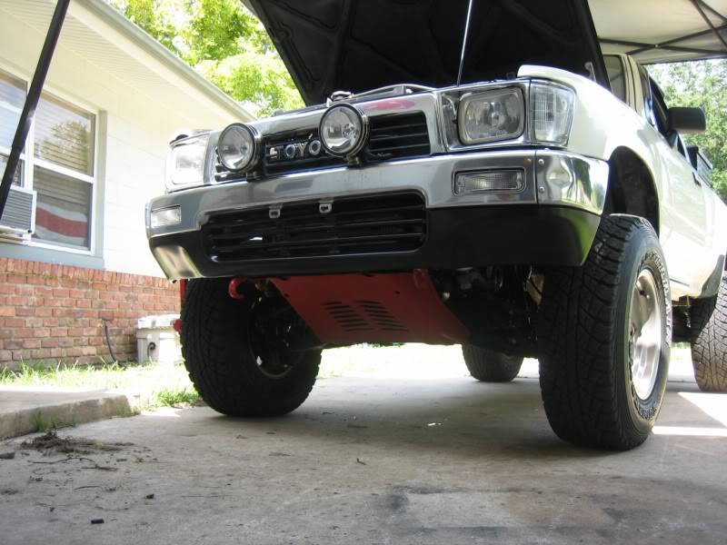

Oh I think that it should come into spec...
if I managed to get this monstrocity aligned good, then a set of ball-joint spacers should be no problem...
