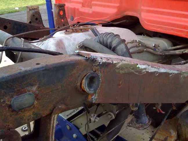

Hey, I saw this thread. I am in the middle of a similar frame problem (maybe a little worse for mine) on a 92. I am sleeving the weakened area with 1/4 in steel flat bar, and replacing the OEM springs with chevy 63's. that will move the spring eyes to a more solid section of frame, and give a better ride too.

no weak areas on this frame ... it's all good , just surface rust .
