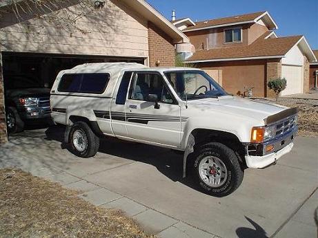

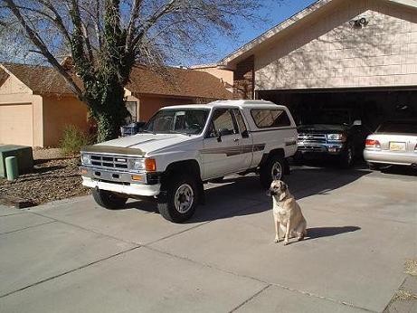

Well guys here are the pictures I've been promising. I didn't really notice until I snapped some photos but the back end is low. I measured and it's 3 inches lower than the front. I'll be making some lift blocks here in the next couple of weeks. Do you guys think that some 3" thick plate aluminum will work without crushing?
Enjoy the pictures.

Nice truck. Very clean.

Very clean truck. My first Yota was an '86 4Runner. Always liked the SR5 stickers of that year.. From previous experience with blocks I would suggest going with a rear add a leaf or some new rear springs if you can.
For some reason Rear springs is something toyota has never gotten right....All 5 of the Toy trucks I have had over the years have had a saggy butt. My '05 goes in to the dealer for new rear springs being replaced under a TSB...

Nice truck!
I would do add a leafs instead of blocks. I have a set of add a leafs that I'll sell you for $25.00.
I had them on my 4runner before I got new springs. Just PM me if you are interested.
