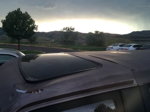

Hey everyone! I have been a Toyota guy for a few years now and have been a lurker on these forums for a while. I am selling my 98' Tacoma because I just bought my dream rig: a first gen SR5 Runner!
Current Condition/Specs:
  • 197,000 on the clock; engine was making a noise so the PO had a wheeling buddy put in a new 22re "with around the same number of miles". The front main seal appears to be seeping, and the oil pressure gauge isn't working. This is my biggest concern. The wiring to the oil pressure sending unit was pieced together with a butt connector so I'm wondering if it's not just that connection. I'll probably try to patch that up to try and get a reading in the meantime until I rewire it and get a new sender. Eventually I hope for a full engine rebuild, but for now I will probably be doing the FMS by myself! She has started to sputter and take a while upon startup. Any ideas? Plugs and wires?
  • The factory paint was the original cherry red. One of the POs decided to paint it a maroon color (which I am pretty fond of tbh). That being said, they just painted over the red with little to no sanding, and the clear coat is gone with a number of dents and dings. It will need a repaint and some body work; the rust is pretty minimal, relatively speaking. There is some in the door jambs, around the inner seal by the sunroof, and then a little on the hood. Overall, pretty cancer free. Took it to a highly reviewed shop in town and he gave me a rough quote of $7000 for all the body work. He said it would need a new hood (which I could paint myself) and that I could push the dent on top out with a bottle jack and a piece of wood; he also encouraged me to get a weatherstripping kit now as they would only go up in price. Seems like this would bring my price down a bit, but I'm not sure. One of the fiberglass rail pieces is broken off on the driver's side, so he said I would need a new top too. It was kinda discouraging for a kid on a college budget, so I'll get everything cleaned up mechanically and just prevent further damage until I have a healthy amount of money pooled.
  • Of course it has the standard weird things here and there as well. The cruise isn't working, the fuel sender is probably out (gas gauge isn't working either), it is missing some trim/has some damaged trim and some of the screws are wrong. There are 6" speakers by the back seat and 6x9s mounted in the rear, and I am sure the wiring for those will be a nightmare. Also the break lights aren't working, which is something that needs addressed soon. I don't know if the bulbs happen to both be burnt out or if there is something wrong with the connection, but I will be testing soon. The power mirrors do not work as well. I will need to replace one of the passenger tie rods and I know some of the other steering components have play. Overall she just needs some cleaning and refreshing!
Initial Photos:
Goal: I am a college student who does a lot of fly fishing and backpacking. I was originally dead set on getting an '85 (and even looked at a few), but I'm not going to be doing major crawling and in all reality IFS is the better option for me. I picked this one up on the cheap, and I am looking to restore it as close to factory as I can (cleaning, replacing, rewiring all of the POs' hack jobs, etc), and then make it a little bit more off-road capable with bigger tires, small lift, armor, tire/jack carrier, rack etc. My Tacoma is in great condition with only 127k on the clock, so I should have a healthy chunk of change to work with in the near future!
Hopefully I am not too naive in what I can accomplish haha
I will be documenting my whole process here, and will likely need a bunch of advice from folks. It's great to be a part of such a helpful and knowledgeable community!
