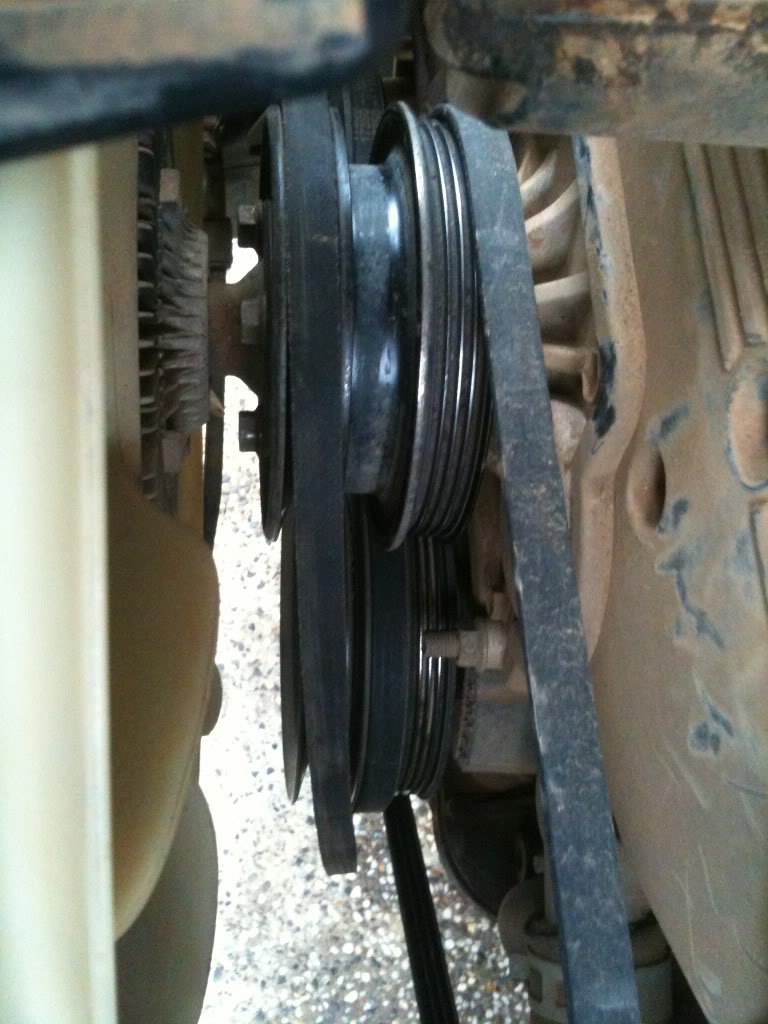

Hello! This is my first post and I need some help, so I was out playing in the snow when I lost my power steering. I assumed I slipped a belt. Upon getting out and looking in the engine bay I see not only had I slipped the belt, I had lost the whole bottom pulley. In this picture I am missing the pulley closest to the radiator on the harmonic balancer. I'm lost as to what to do and any help would be greatly appreciated. Also I did a fair amount of searching and cant find anything on this subject!

Im trying to figure out what broke. Is the crank bolt still there?? or is it the 4 little bolts that hold the pulleys together?

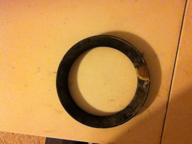

This is all I have! It looks like it just fell off from the other two pulleys?? Sorry phone picture!

All 4 bolts are on, and the crank bolt I believe, but its hard to see it in the dark! I felt all bolts but cant see much with fan shroud on.
Old Dec 7, 2013 | 07:26 PM
bone collector's Avatar
Joined: Nov 2009
Posts: 2,025
Likes: 40
From: Northen Indiana
wow... crazy stuff. you definitely need to pull off the rest of the crank pulley to see what happened

http://personal.utulsa.edu/~nathan-b...67timingbe.pdf
based on the pictures in this diagram. and your picture. it looks like the pulley sheared from the mounting plate that has the 4 bolts. in the morning I would be curious if there are 4 bolts on the crank pulley that are holding a plate with no pulley
