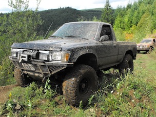

Pretty little truck before SAS'ing
33'' maxis big horns, no lift and cut fenders. Took about 2 1/2'' off the fenders
Spooled in the rear with 4.88's this thing did amazing.
