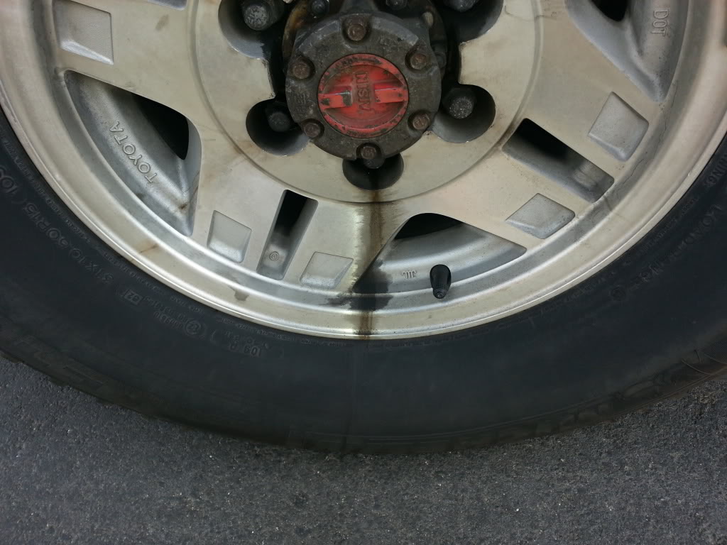

oil leak fom the wheel. check it out
What might cause this?

The seals on your hub may be shot, causing the grease to leak out when you are parked.

^-- x2 wheel hub assembly leaking.

Sorry.... does that mean the seals in the manual locking hubs or deeper than that?
This part?

Yes the hubs, since the seals are gone I would take out the bearings check them and replace the seal on the back side of the hub also. If its like that the grease has broken down and liquified.

^^ i was just going to say that. The way the grease is just running down the wheel looks as if it has liquified. Now would be as good of time as ever to repack the wheel bearings.

There's an additional seal on the front dial. I think all 3 seals/gaskets for them are between $5-10 per hub. Really not much to cleaning them. 4x4wire or Pirate has a really good thread w/ pictures. But not enough grease in the hubs themselves to cause your issue.
It looks like your wheel bearing grease has failed. Time to repack. New bearings are only about $40 I think. Labor to repack them is probably about 2-2.5 hours. You'll also need new axle/bearing grease seals on the inside side that are about $15/side. Or you can do it yourself. Can either buy new bearings in advance or check once you get the wheels torn down. You should notice play when wheels off the ground if bearings are loose/lacking grease.
Have you recently done any water crossings above the axles by chance? That might pull both water and grease out which makes more sense than the grease doing it all on its own.

I recently did water crossing and mud play that was about axle Height. There is play in the axle.

Looks like you've identified your problem...
To clarify, if you've regularly checked for bearing play, and this is new, your bearings are probably fine. If you haven't, they could be bad... If you quickly you get around to repacking after the grease washing out, you should be fine... These OEM bearings are pretty hardy.
