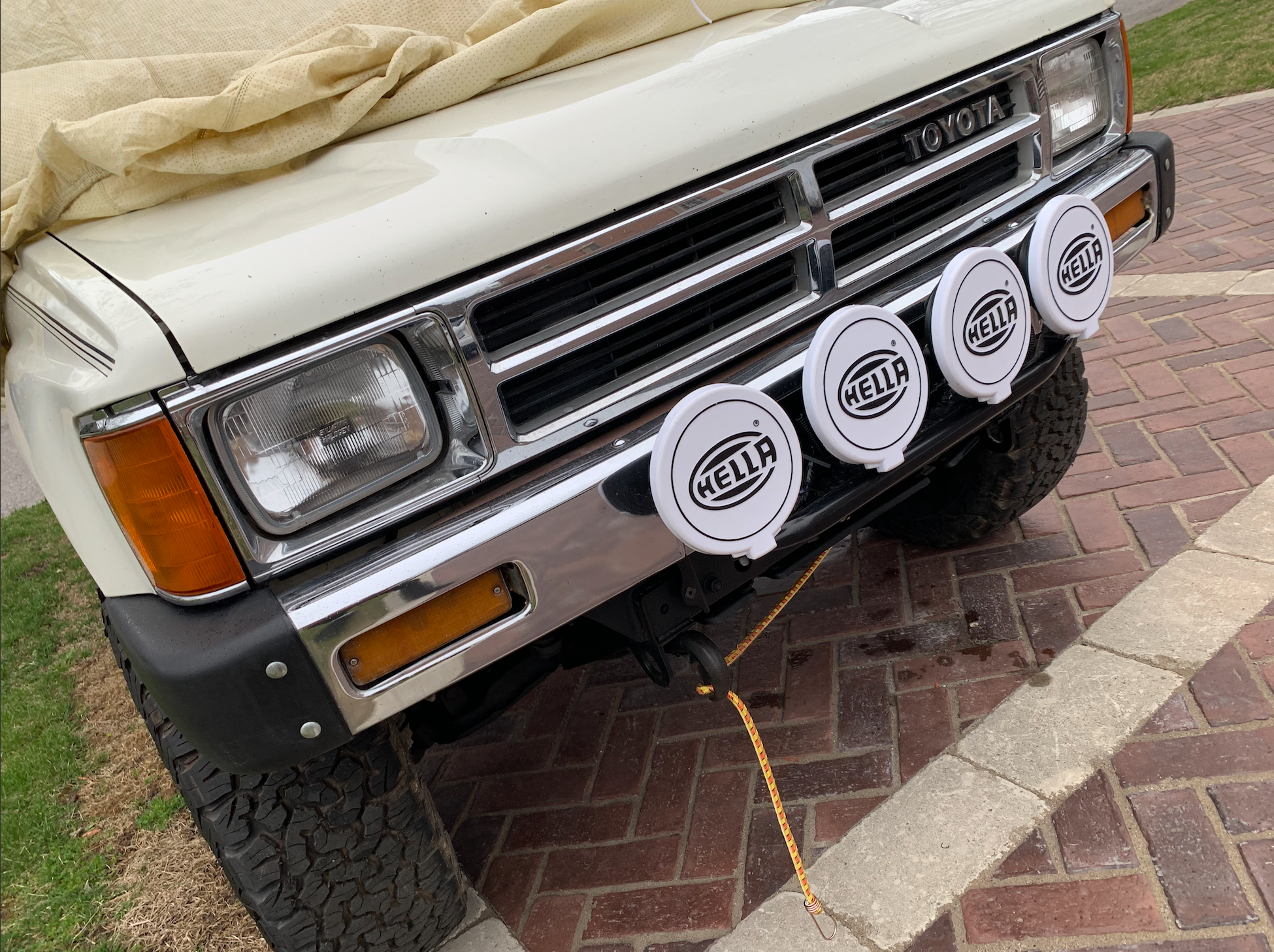

Congrats on your new ride... the teaser pic looks like a very slick ride... more pics please.
info on your rig will be very helpful in the future, the more the better.
