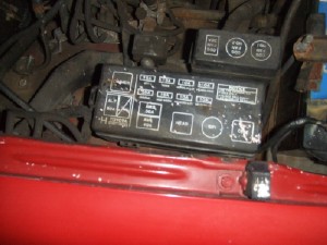

Here are some pictures to help.. just took them.. and its dark.. so if it hurts and dosent help.. I can grab some tommorrow.. I really hope its that, because that tank is gonna be a pain to take down. Almost 20 year old bolts DO not want to move.. I bought a craftsman rust out bolt set.. saved my life.

The little grey bow up and to the left, just above the large fuse.. thats the test/jumper box. Thats the one you will be working with. Open it, on the cap, which will open to the right will be a list of what each spot is.. find the fp+ and connect it to b+.. thats the postive side of the battery.. direct power back to fuel pump.. If it dosent start..
