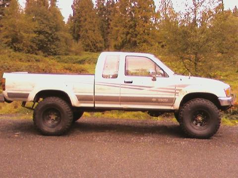

just 1.5" shackles in the rear to level saggy leaf springs

Looks good! Thx for sharing. WHat size rims are those? 15X_?

their 15x8, i got the tires which are bfg mud terrains 33x12.50 for 100 bucks with about 90% tread from a buddy and bought the rims new, their just cheapie rock crawlers, i didnt even plan on putting them on until i got my straight axle in (in the process of aquiring all the parts) but somebody apperently thought all four of my tires was a good place to put their knife so here it is.

So no rubbing at all when the front wheels are fully turned during driving on pavements and bumpy roads?

i had to beat down the pinch weld behind the tire but after i did that it only barely rubs if the front is maxed out on flex

I have wondered if my 2" lift shackles would help my saggy butt, your truck looks nice with them. Was it hard to replace your old shackles? Were the old ones tough to get out? The bushing requires that you take the leaves off and put them in a press to get them out or did you choose to burn them out? How did you do your shackle job?

putting the shackles on took all of about a half an hour and and that the bushings just slid out fairly easy, i should have replaced them with new one but i just gobbed some grease on em and called it done, can't beat it for $35

hey i got 33 12.50 on my 91 stock and i barley rub on the front plastic on a slow sharp turn
