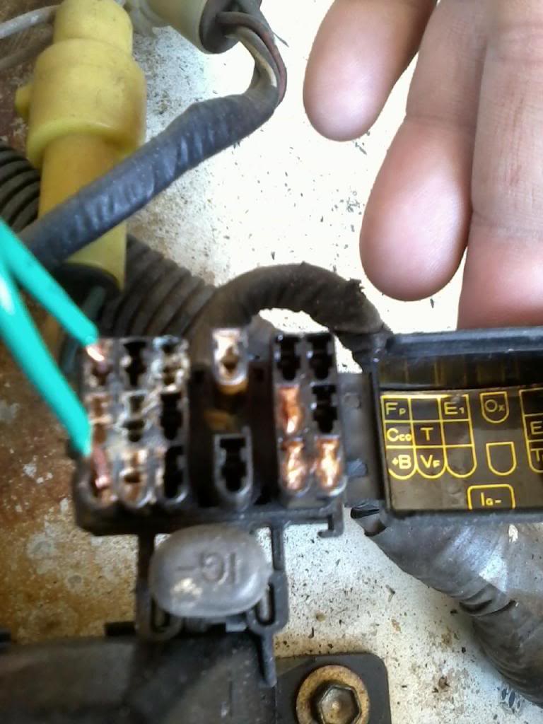

The harness is supposed to be from an 86, however i am not sure which is why im seeking help on here. most of the plugs look the same but wire colors are different in places. Some of it i will not need since i am "desmogging/ EGR deleting" it .

there are some differences between early '86 and the '87 models. the '87 had the diagnostic connector with multiple ports, ie, to jump Fp and B+, or to run in base timing mode.
there are also some relays present in '87 not found in early '86s.

I miss read the original post. I thought you were trying to put a 94 harness into an 86. Like Wally mentioned, there is some differences in the wiring and the Diagnostic Port is one of them. 87 they started using more square plugs over the round plugs. Toyota changed 2 of the 4 wiring color stripes on the Wiper motor alone. All blue wires but the stripes changed. There are others wire colors they changed as well that I cant recall right off.
Here is the differences in Diagnostic Ports.
How to get Check Engine Codes. I just put this up for others. Applies to 87 and up. 86 and older is the bottom picture. TE1/E1
The Diagnostic port for the 85-86 is on the Drivers side inner fender and is nothing the same as the 87 and up. Here is T1 and E1 jumped. The codes and engine flashes are the same as the rest of the trucks on the dash.

Ok that is one of the differences in the harness that is original and the harness that i have bought. The purchased harness has the square black Diagnostic port and the original harness has what im assuming to be the diagnostic ports on the Drivers fender in two rubber grommets that are mounted to the fender. The rest of the connections seem to match up with the exception of some color differences. The Diagnostic ports definitely had me puzzled. Which is also why im hoping to find out exactly what i have so that i can compare the two diagrams. After that I think it will be just a matter of laying them both out and comparing the two while testing and cleaning everything as i go.
