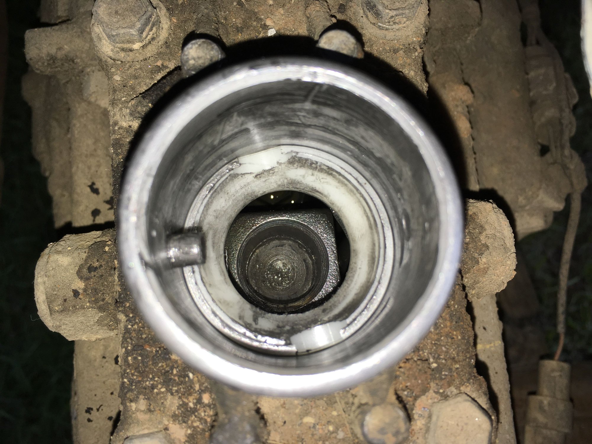

I need advice on what to do with the transmission shifter retainer. One of the pins is broke off that holds the retainer/spring down. I'm sure most of you know what I'm referring to.
Should I try to do something with the one I have? Try to find a new or used one?
I love the truck and have a LOT of money in it. I never plan to get rid of it. It's not in the best condition but it's far from the worst. I get compliments on it constantly at stores and redlights. I use it daily for my work truck and wanna start using it to pull a small aluminum boat.
Gonna try and post some pictures on what's broken.

Here are 2 pics if they post...
Pic 2
Pic 1

drill out or punch out the old pin, and press in a new one.

Where do I get a new pin? What size is it?

You could also get a new base from the junk yard.

Do you recommend any online junkyards who might have it? I received an email back from Yota Yard that stated they were checking on it and for me to call today.
