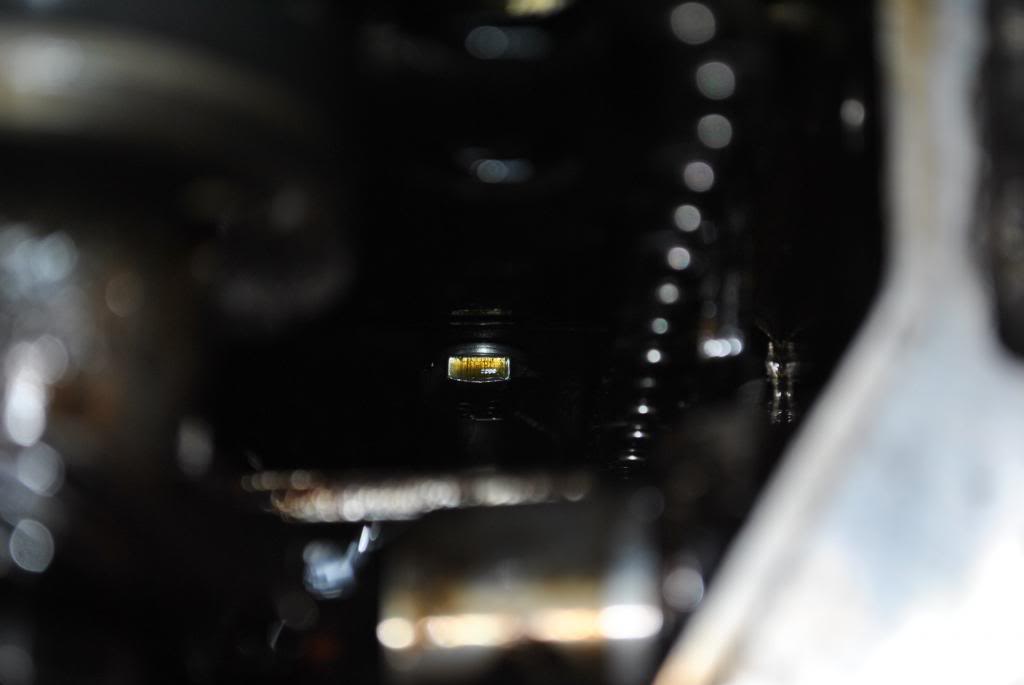

changed my timing chain 2 weeks ago. got everything, chain,sprockets, metal backed guide on right side and plastic on left side and new tensioner. all gaskets and stuff. was not able to check my valve lash so put it all together and drove it. now i hear a ticking noise figured it was my exhaust or valves. kinda sounds like a diesel, so pulled the cover checked the valves and all were good. checked the chain and it felt tight but the bolts that hold the metal backed guide were chewed up like the chain was hitting it. how could it be hitting them? i did notice the bolts and lock washers that came with kit, made bolts stick out farther then the old ones. should i have just reused the old bolts? im really not feeling like taking this apart again. chain still looks good but why is there slack in it like that? i checked the tensioner when i installed the new one it moved freely and chain was tight before cover went back on. anyway not sure if this was my noise but i discovered only 1 of 3 bolts were were tight where manifold meets down pipe. should i worry about the chain hitting the bolts though?
Old Apr 3, 2014 | 11:29 AM
Inferno451's Avatar
Joined: Apr 2010
Posts: 481
Likes: 9
From: Spokane, WA
That doesnt look good to me. Who's kit did you use?
