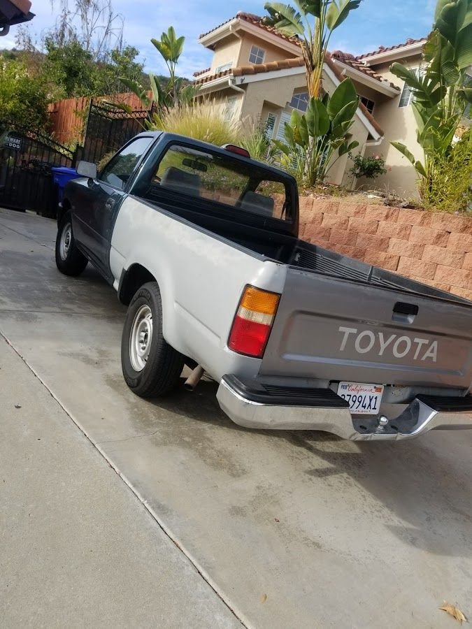

Hey all,
I'm new here. Just a quick background. I have two motorcycles, was involved in a hit and run on one of my bikes and sustained some bad injuries so I needed a daily transportation (preferably a truck). Bought a used 1994 Toyota Pickup. The seller told me the engine was original, but after doing some research and looking at the receipts in the glove, I realized it was swapped. The original engine was a 3VZE but currently has a 22re (reason I bought it). I don't know how many miles are on it. The odometer says 134k but can very well be incorrect. I plan to keep this truck until the wheels fall off, so I wanted to invest some money into it. It is in dire need of a paint job, and some small cosmetic and suspension upgrades. Before I did that, I wanted to get everyone's input on it. The engine sounds and runs strong. No visible leaks. The engine bay looks almost brand new. Is there anything that I should look for before investing money into it? Any common problems that could be an issue here? I called around and found a shop that charges $80 to do a full inspection and plan on doing this. Anything I should replace? Thanks all for your help and glad to have this oldie but goodie pickup!

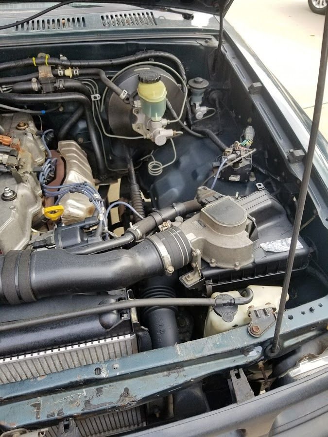

Wow, clean engine bay!!!!

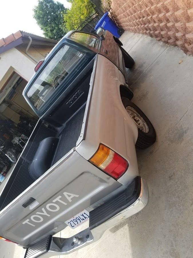

The body on that thing looks pretty straight and rust free! You should be able to enjoy the truck as a good reliable commuter vehicle for years to come. Don't worry about the head gasket unless it actually fails, and even if it does it's doable for you with some hand tools and a good torque wrench, just read the manual and label the parts when you take it apart. We've recently removed heads for a stripped spark plug hole on a 1989 v6 Nissan, it's really not that hard if you go about it methodically, and just take the head to a machine shop once you've got it off, they charged me $80 for both to clean, inspect, and re tap spark plug hole.
