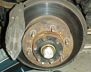

Old Dec 7, 2013 | 06:11 PM
JasonYota's Avatar
Joined: Mar 2013
Posts: 2,121
From: Mobile, Alabama
ADD type
Automatic locking type
Old Dec 7, 2013 | 06:19 PM
1500cummins's Avatar
Joined: Dec 2013
Posts: 10
most def. the first picture. so i guess i have add.. So does that mean i have that brass bushing that needs to be greased.. i hope i get this fixed tomorrow as its -14 right now and my diesel does not like it.
