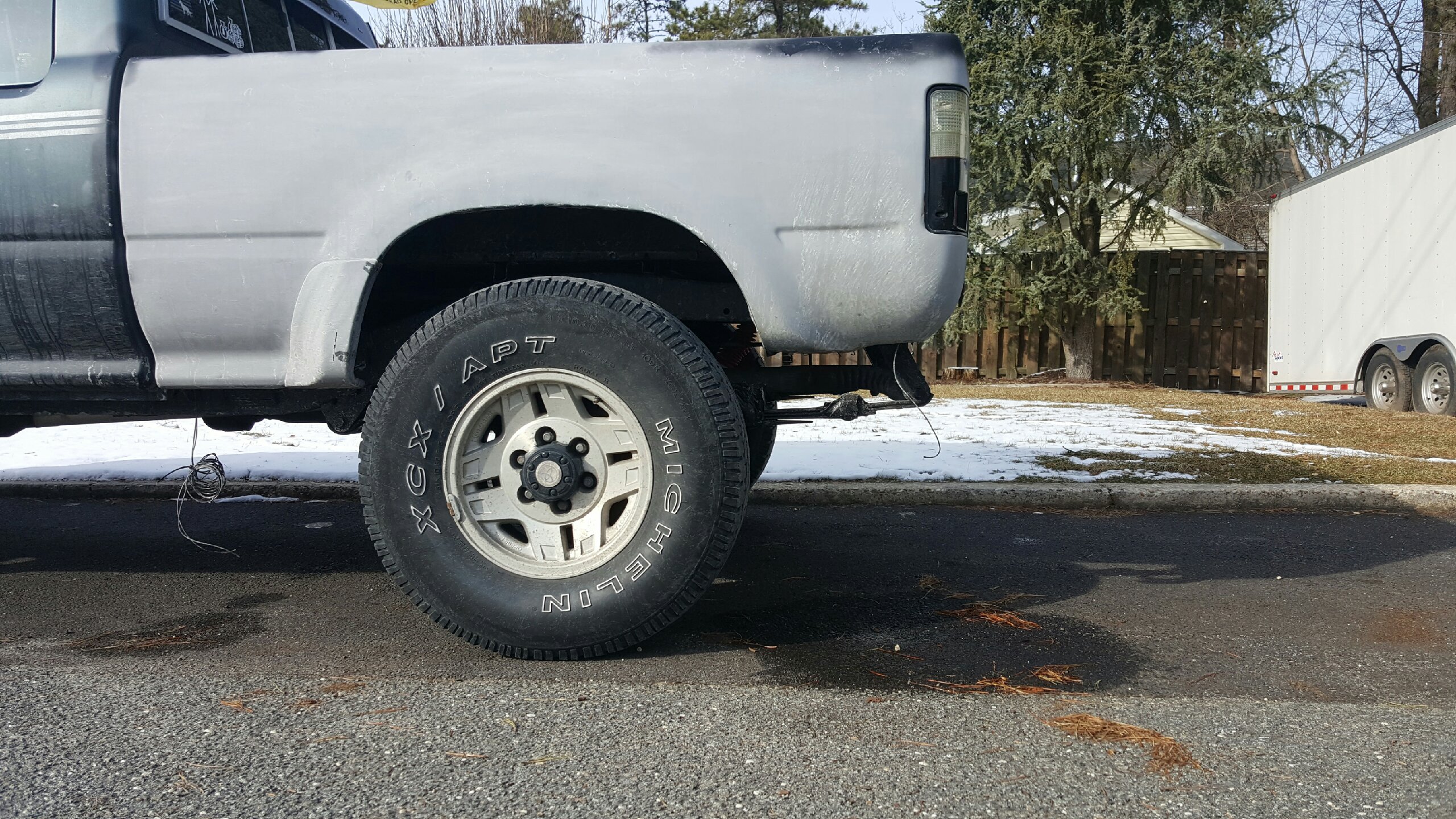

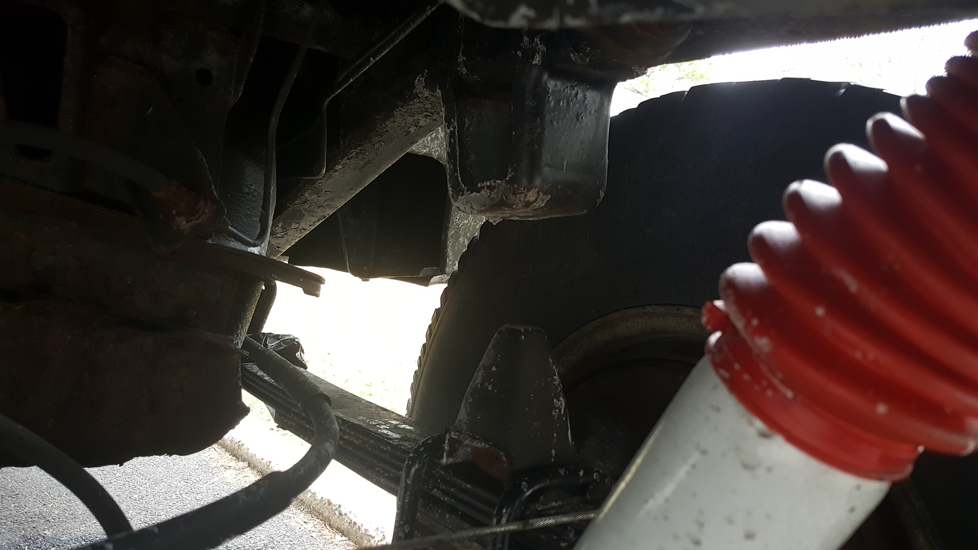

I just purchased new leaf springs for my 1993 Toyota Pickup ext. cab 4x4 V6. I purchased it with Skyjacker SoftRide springs that gave a 4" lift and it rode horribly. I replaced the leaf pack with some OEM style packs from SDtrucksprings (http://www.sdtrucksprings.com/index....oducts_id=7504) model 90-135. I also replaced the rear shocks with some Skyjacker Hydro7000s (0-2" lift). After installing the new leaf springs, the rear of the truck looked like it was sagging, so I installed some 2" Lift Shackles. The truck sits almost level but the NEW leaf packs are almost flat with no arch (maybe 0.5" of free space between the bottom spring and the overload spring) and the truck rides super rough. By rough I mean it jolts and rattles and lurches over even the smallest bumps....you feel it in your spine. The truck rode the same way with the stock shackles in it. I There is good space between the leaf pack and the bump stop so I dont know if they are hitting. Could the springs be bad from the manufacturer? Ive done research on the ZUK mod and it seems people go either way with it....some say it roughens the ride, others say it softens the ride. Ive Googled and Googled and searched and searched and I can not for the life of me find what size spring to use that would replace the 2" lift shackles, Level the truck out and soften the ride a bit. She is 98% of the time a commuter, very rarely sees a trail.
The front suspension has a 1.5" BJS, Diff and sway bar drop, and new Hydro 7000's. I have not touched the Torsion bars. Pictures included.........I understand its a light weight yota and they ride rough to begin with, but this seems extreme. Any help you guys can give would be great.

Did you put springs in backwards? Axle is too far forward.
Anytime you you go to lift a vehicle by using same length spring but more arch the ride gets rough. Maybe if you pony up for alacan made not or not as bad. If you want to lift and keep same ride quality you need to go to a longer spring. Compare spring rates. Skyjacker is well know for a crappie ride.

Springs are right, long side back. But it does look a tad forward.
But those springs look shot. If they are new they shouldnt be that flat? Maybe put an add a leaf in them? or hate to say it, but try another set pf springs.

Next question? Are they the right springs for the year?? Yota used several different lengths.
can you get a pic of underneath? I'd like to see distance between bump stops.

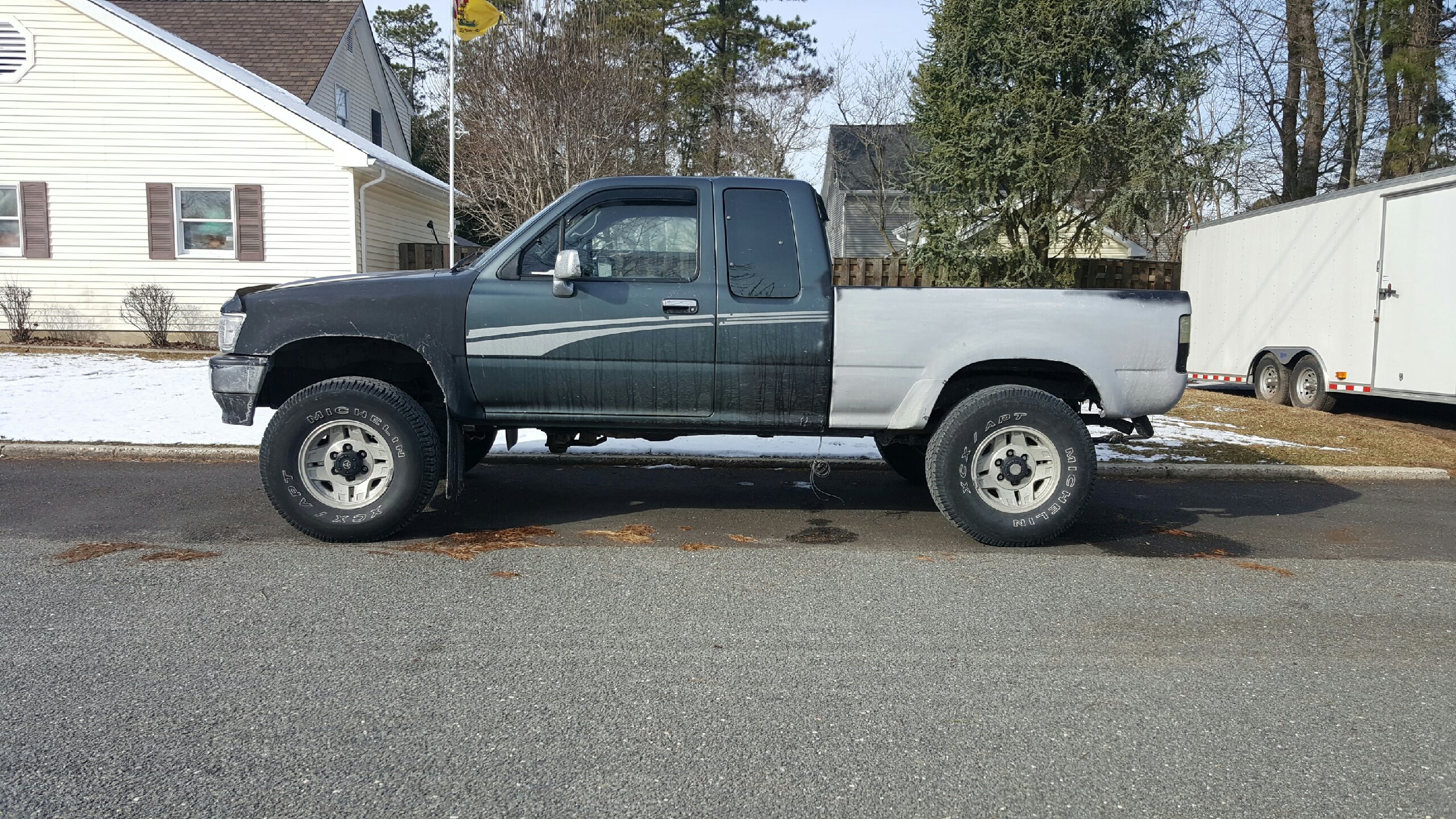

The site ssid for a 1993 Toyota Pickup 4x4 extra cab....which is what I have. Here is a pic of the bump stop...
Attached Thumbnails New Leaf Springs/ Rough ride...ZUK?-20170211_140634.jpg

so the reason he suggested adding weight to back is: stock length and more arch makes increase spring rate. So adding weight will make the ride feel better. If your hitting bump stops do Zuk mod to add more spring.
Testing out both methods and see what works best.
Me I'd drop tank, measure pinion angle, install new hangars 10.5" forward of stock hangar, get a set of chevy 63's, move my rear shackle mount back 3", crunch some math, make some longer shackles. Lift and plush ride while recentering axle in wheel well. Was a fun project. Need new shocks, wanting Rancho 5000s but funds

I took the Skyjackers off. The brand new OEM are sitting flatter than i suspected...so more weight would be counterintuitive

You should probably measure those "135s" and make sure you got the right parts and not a set of "115s". Someone else mentioned it doesn't look centered properly.
89+ should be 29.25" from center pin to rear, 88- are 26.75" according to their data..

I measured the springs this AM when I got home from work. Around 29" and change. Waiting to hear back from SDtrucksprings about a return, Im inclined to think the springs are faulty.
Yes, I bobbed the bed just under a foot to get rid of rust issues. Sprayed the frame too. Looked cool w the rake I had from the Skyjacker springs...just couldnt handle bouncing all over the road. I dont have a spare or a rear bumper so the ass end is really light.

The photo angle in the first image could be a perspective thing, but go ahead and measure the front of you would they say it's 22inch. How is the ride height as measured at the front eyelet, OEM is 16 something from memory.
I have to agree those springs aren't up to par no matter what they measure at, you should be sitting higher with a bobbed bed.
