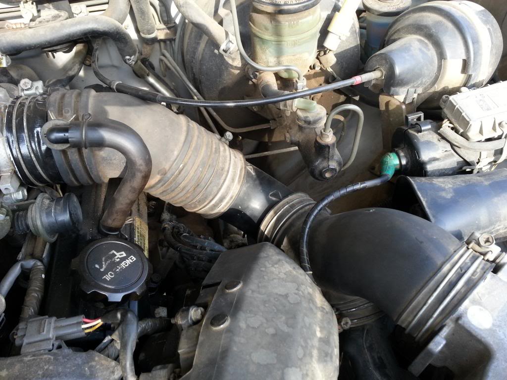

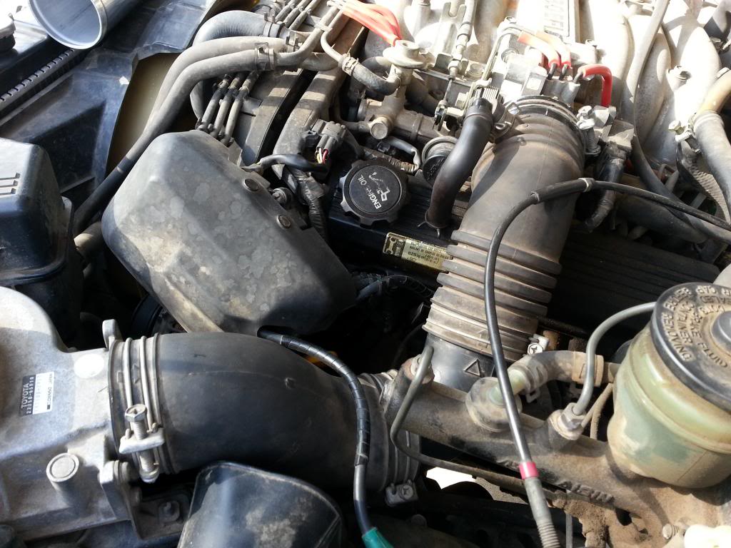

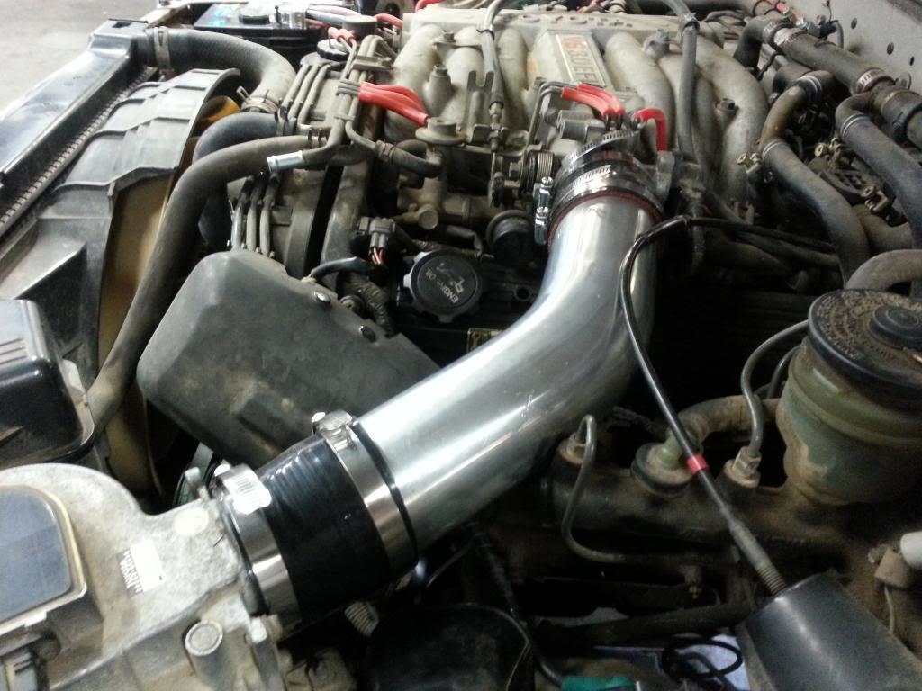

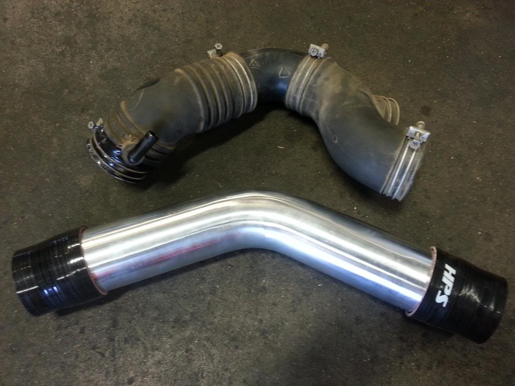

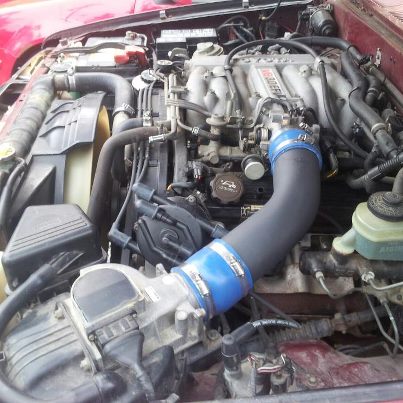

Figured I would show off my new ISR intake that I built, and new exhaust that got welded up yesterday.
New intake:
I have a filter thats coming in for the crackcase vent. I also have a fitting coming in for the other vacuum line that is currently left open because I have been told I will have issues if i just vent it to atmosphere but so far havent had any issues.

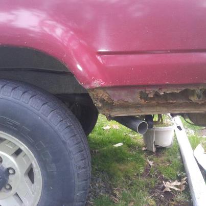

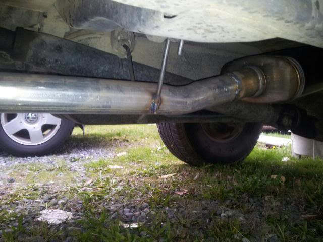

Exhaust: (dont mind the rust )

The exhaust sounds great. Its just 2.25 piping to an 18" magnaflow muffler, and then out the back. Aside from the fact that they welded it solid instead of leaving me a flange somewhere, I think the shop did a great job and am very happy with it
The one thing I have noticed is that when I'm driving and I take my foot off the gas, there is often some popping and crackling that's happening. I did some reading up on it and some people say it's completely normal and some people say it usually indicates an exhaust leak higher up, or leaking valves. Any one got input into this from a Yota 4runner perspective?

It could be that you need more back pressure that is a problem slot of times
Old Mar 27, 2013 | 03:06 PM
stanprophet's Avatar
Joined: Feb 2013
Posts: 167
From: Hampton VA
The popping and cracking means the muffler may be defective, I would be happy to dispose of it for you!
It is perfectly normal for that to happen on a high flow exhaust system. That is a sound that is engineered to not be there in a factory exhaust system on most cars. Jump in a HP car and it will pop and crackle on throttle lift. This is because a performance enthusiast wants that kind of sound.
You changed all exhaust, and the intake, eliminating the Helmholtz resonators in the intake. Thus allowing more engine noise to be heard through the intake and exhaust.
Perfect. That is what i figured but i just wanted to make sure. Thanks for the info.

To expand on this
Back pressure is not really a desirable thing. The engine is just a big air pump, and the less restrictions on intake and exhaust the better. With a cast iron manifold and a full length exhaust there should be little to no measurable back pressure at idle if the system is working correctly.
When the exhaust is shortened and a header added it will cause a loss of low end torque, and gains in high end horsepower. Many people relate heavy exhaust modification and loss in low end torque as a back pressure loss. It has more to do with scavenging effects and less to do with back pressure. Burnt valves can happen on a car running strait headers, since there can be a large lapse between exhaust pulses allowing fresh air to enter the exhaust port of the cylinder head. This caused rapid heating a cooling of the valve, causing a failure. This will not happen on a full length exhaust system unless there is a large exhaust leak. Even with factory exhaust there is little to no back pressure until the engine is on a significant load or RPM.
The design aspects of an exhaust system that make them quiet, is the same thing that causes them to be more restrictive. Most OEM mufflers have a larger inlet than outlet, as the exhaust enters the chamber it hits the perforated tubes and chambers. This causes the exhaust pulses to be smoothed out, and also causes the air to cool and condense. Condensed exhaust takes up less space than hot exhaust. This allows the exhaust to exit the pipe in a much steadier stream, and the smaller outlet is used to help smooth out the cylinder pulses.
On an aftermarket high flow muffler, air can and will enter the exhaust system because of non smooth exhaust pulses. It will never reach the valve, but can reach the muffler. The collision of hot and cold air can make some popping and cracking sounds.
OP: Looks good!

What did you use for your ISR, material wise?
Old Mar 27, 2013 | 06:08 PM
4runrjunkie's Avatar
Joined: Feb 2012
Posts: 82
I just picked up a peice of walker exhaust piping (3" with a 45 degree bend and 4" straight sections on each side of the bend) and two 3" sections of silicon tubing ... It fit perfectly.
What did that run you, like $30-40? Looks great btw!
Pipe was $40 but things in this city always cost more than they should haha. Silicon tube was like $6. With all that and the clamps and paint it was about $50.
Thanks btw, im quite happy how it turned out.

also regarding the popping and crackling: i'd inspect the upper end of your exhaust closest to the motor for leaks. i usually just dip my hand in water and then follow the pipe with it when i'm close to the motor. hate for u to burn out that shiny motor
yeah that's what I was concerned about ... mostly whether it could indicate the crossover was leaking, so maybe I will check it out even if there is a good chance its fine lol

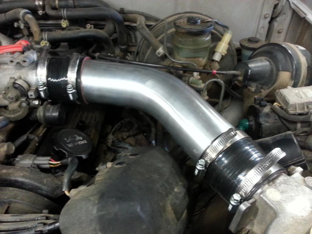

I was looking into doing this, but decided that I'd just get the upper intake boot instead because there was a huge crack developing. Well, I said "Hell no!!!" after I was quoted $70 for this little part alone (and that's with my employee discount)!
So I went to the hot rod store, and the only steel pipe I found (which wasn't even 3-inches) was retailing for $75! Instead, I came home and ordered a 3-inch, 45-degree bent aluminum "intercooler" pipe from Amazon for $15, and 2 3-inch-to2.75-inch silicone connectors (the stock throttle body inlet and air meter outlets are 2.75-inches in diameter) for $13 each. Grand total of parts was about $60 after shipping. I know, they charged a load for shipping.....
Anyway, my before and after pics:

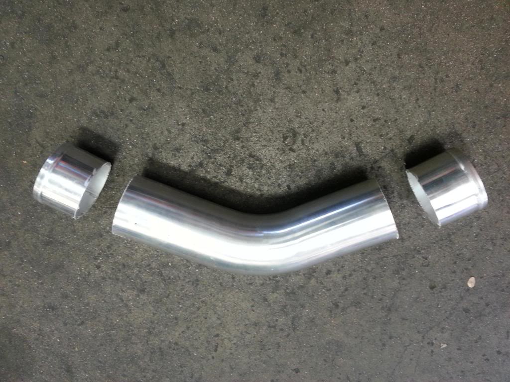

Here's the parts:
Old parts versus new parts:
I didn't have a pipe cutter available, which would have made much cleaner parts, so I used a cutoff wheel instead:
I didn't have time to incorporate the fittings for the 2 lines that go into that part of the intake tube, but will later on.
One little problem that I did run into was that the pipe is now hitting my brake master cylinder (as you can see in the "after" pictures in my previous post), and will rub against it. My remedy? Well, for now, I stuck a little square piece of velcro on the intake pipe right where it rests against the master cylinder. I may or may not choose to fix this later.
Overall, I built this intake pipe for less than just the upper rubber piece from the dealership.
