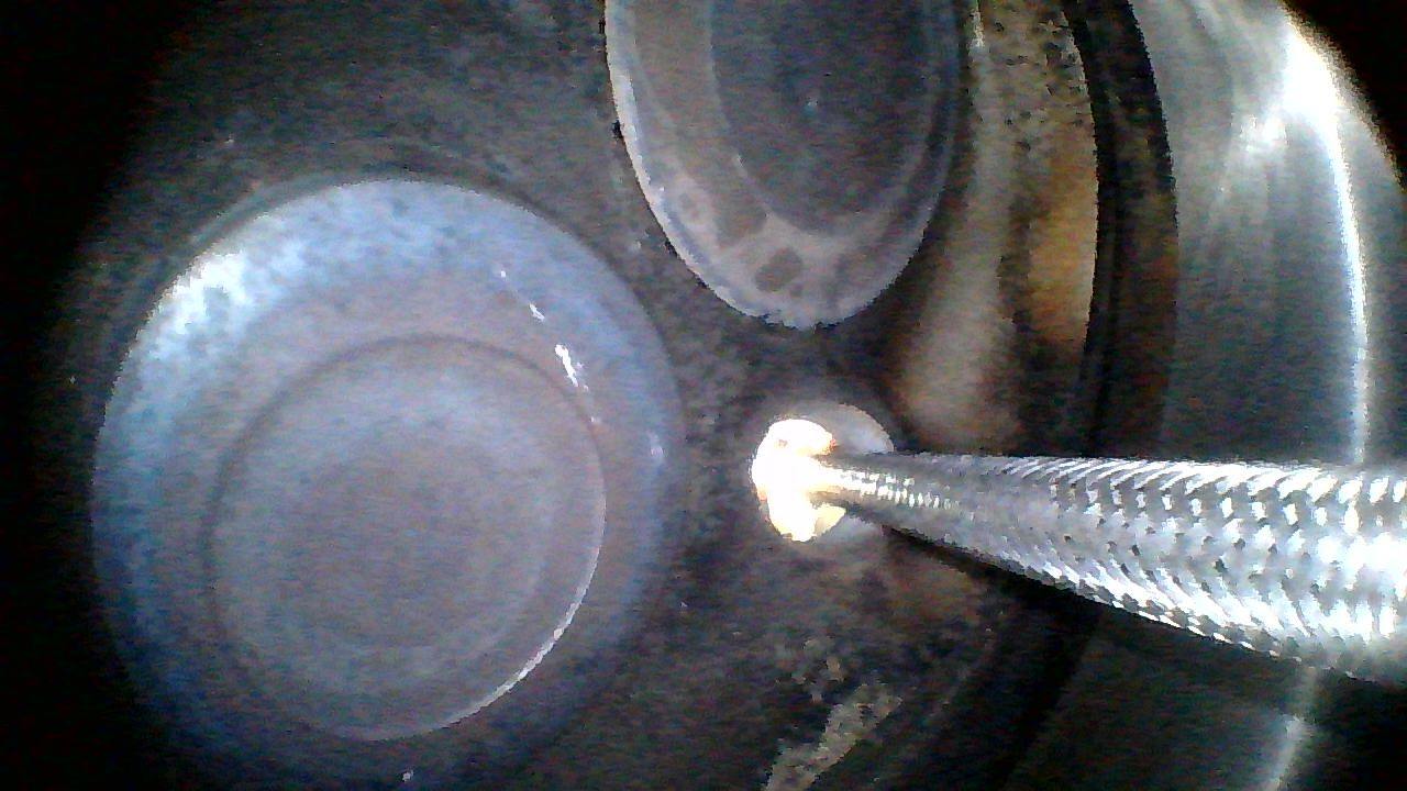

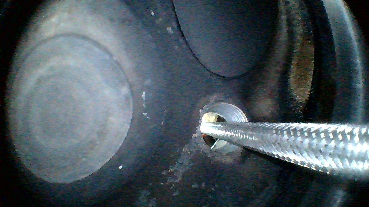

1400 miles on a new engine. Trying to figure out if it is to lean or not. I have a mixture gauge installed and it says to rich at Idle and optimal at cruse. Getting only 14 mpg highway and 13 city. Runs strong with ported heads but I am concerned that the chamber and valves are not getting much color. Pics attached

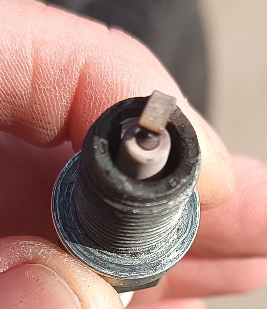

Is it pinging or knocking or making any weird noises? Plug looks good to me.

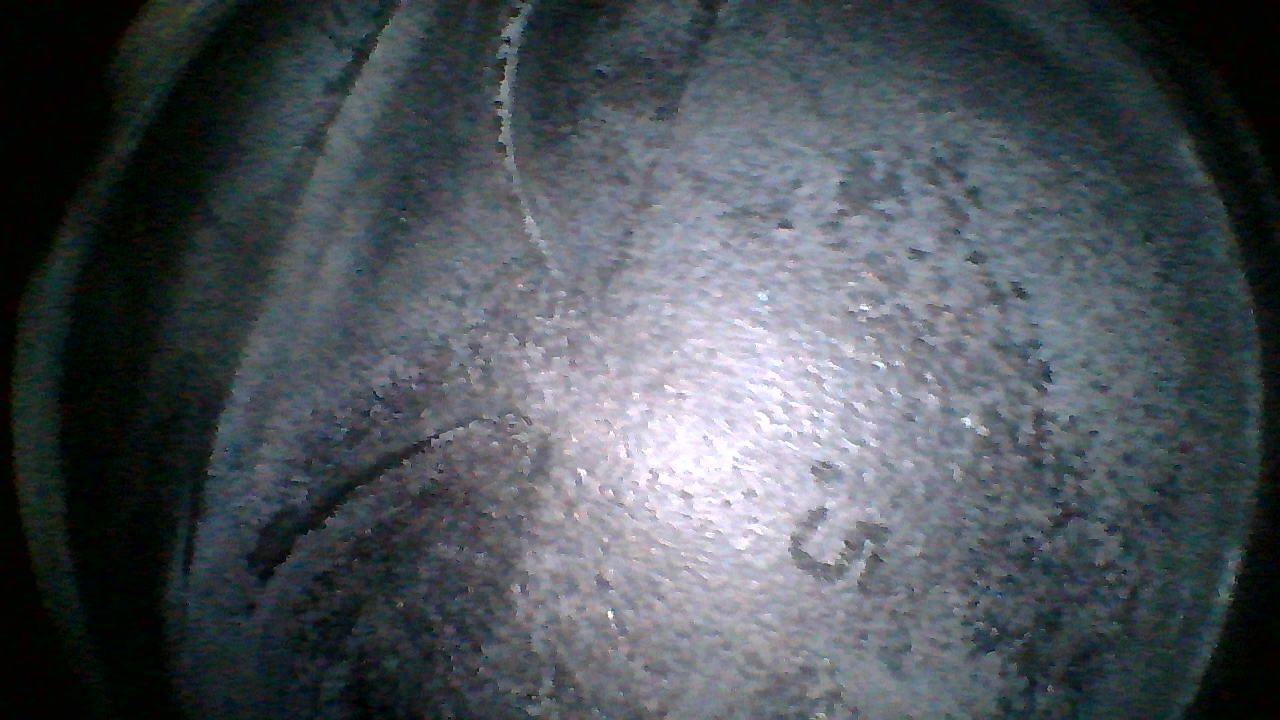

No, there is no pinging that I can hear. The engine runs fine and very strong. It originally was leaving powdery carbon on the valves and black deposits on the piston surface so I went two clicks clockwise (lean) on the air valve. Then the one valve was getting a very light yellowish deposits on the valves. I then went another click and now the carbon on the pistons is gone and the valves are clean as in the pictures. I have never had one go clean on me before. Worries me that it's so clean. Does that mean it's to lean? Here is a pic of before I leaned the mixture.

I'm no engine expert but the plug looks good to me.
