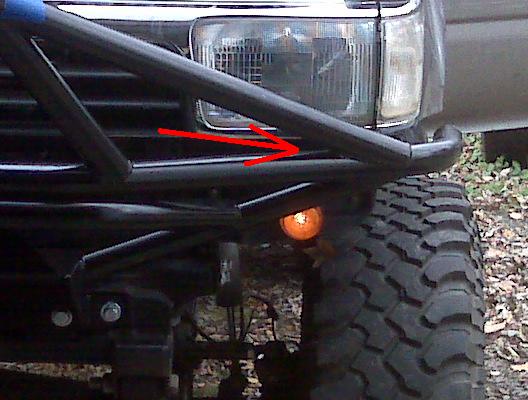

Check out my new blinkers set up for my 4runner with the new bumper, got them hung on the old stock sheet metal that go's behind the stock bumper.
The area they are mounted on keeps them about 4" behind the new bumper but still visible from the front,now I need to figure out why they blink so fast as directionals but on 4 way they blink at normal rate any ideas anybody?
Cell phone pic's but they get the point across yea?

do you have them hooked up to your normal blinker location?
does it replace the stock blinker or is it just spliced into it?

how many watts is the bulb ? could be why it blinks fast

Add some load equalizers. They are $10 at Kragen. Problem solved. Same as if you are using led's.

Yea they are for the most part spliced in I have the hot side pined into the pin area for the stock connection no ground though I tried that too but it made no difference
Wonder if that will work, I have one on my Harley to equal the load from the 6 l.e.d.s but I don't know if that will work if the 4 ways blink at regular speed but I will see if I can find one and try it out Thanks for the info, I had wondered if it would be like a l.e.d. set up

it just sounds like a bulb is burnt? When you rear turn signal goes out your front blinks twice as fast, or vice versa.
I think your splice is making it have less resistance? just food for thought.

Alternately, you could use a trailer light converter box and not have to change any bulbs or modify the housings. Wire the turn signal and marker light wiring to the box, then wire the box to the bulbs in the corners. Lights will be on with the markers and blink on and off with the signals. You might have to replace the stock flasher unit with an electronic one so that the flash rate is normal though.

I just cut the wires to the sockets and moved the indicator wires up to my marker lights. I used Amber bulbs in my old marker sockets and it works perfect. I then ran my marker wires down to my driving lights / fog lights and now have fog lights wired into my factory headlight switch.

The easiest thing to do would put brighter bulbs in. I did the exact same mod when my truck was bumperless, switched in bigger bulbs, worked great and was really bright too lol
