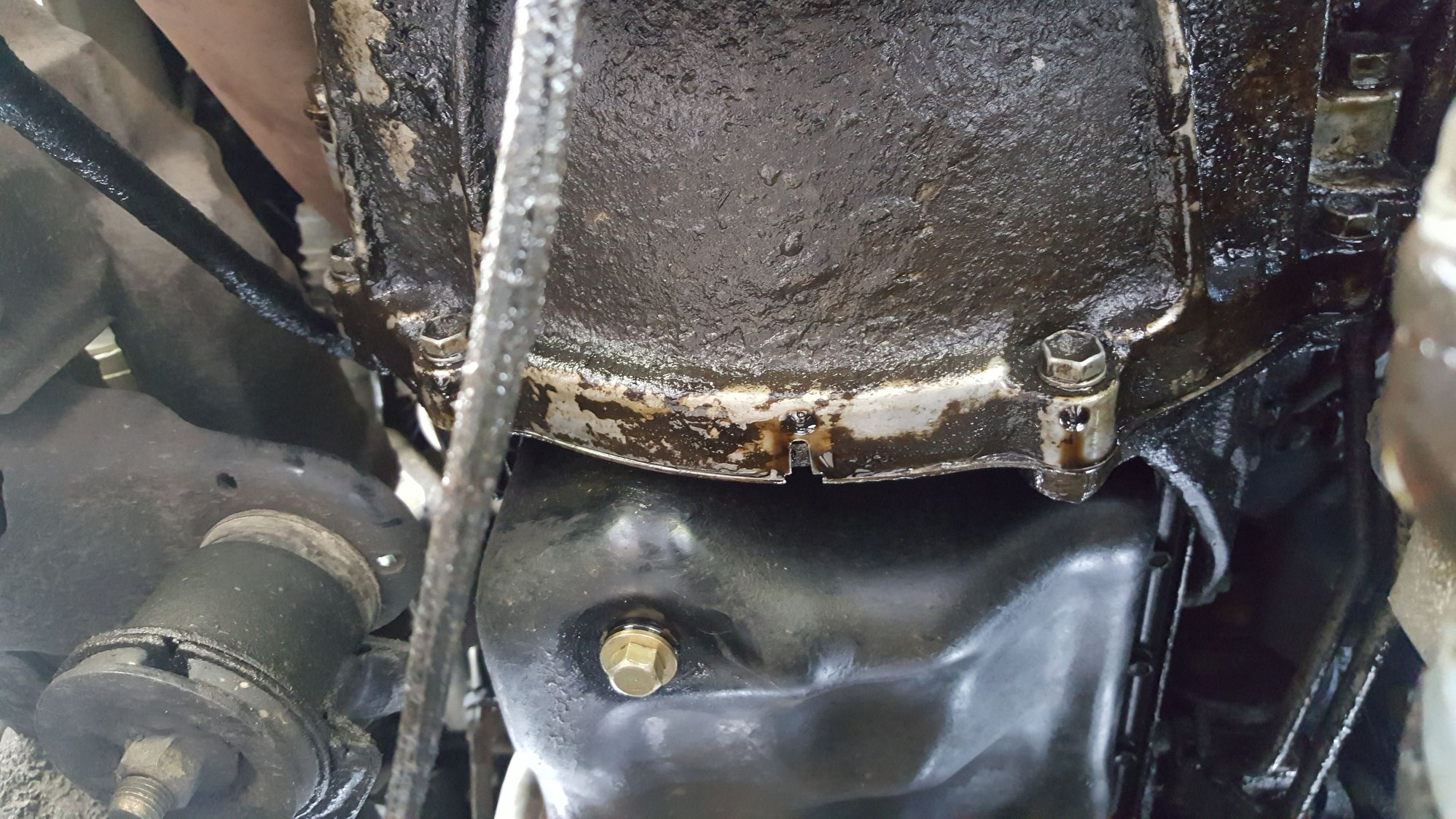

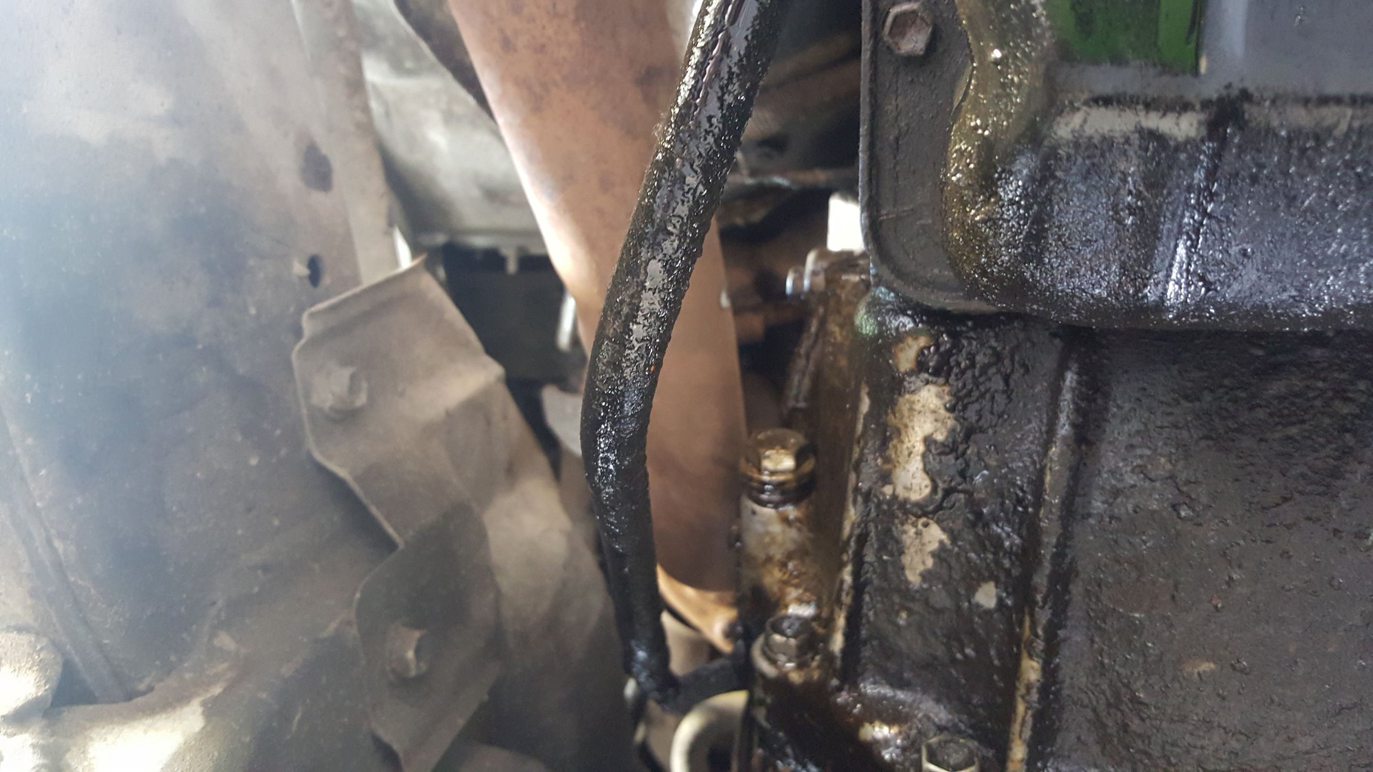

So i purchased a 1990 4runner 4x4 auto with v6 a few weeks ago and its been leaking fluid from the front end. I changed the oil and put some lucas oil stop leak in it to hopefully slow the leak down. Didnt help. Its been over a week since oil change, steady puddles everytime i park. My oil level has not went down at all though. Trans fluid is good on levels too.
Im thinking it is something in the dtiveline but not sure what. Drove home from work tonight (4 mile drive) and when i parked it i noticed a burning smell...
I included some pictures from underneath. Any help would be greatly appreciated!!!

Looks like your oil drain bolt From the picture it looks like a rubber o ring under it rather then the correct gasket . Might just be the picture though
If not that rear main seal leaking out the front of the bell housing .
Is it engine oil or Transmission fluid ?? They smell quite different
The smell may have been what ever fluid burning off the exhaust .

the entire bottom of that bell housing is coated with oil, it's going to be hard to troubleshoot the source.
take it into the car wash and blow the engine and tranny off with high-pressure wash.

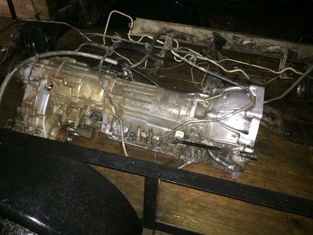

Breather
Originally Posted by Kbarn09
If it wouldnt be too much trouble to snap a pic that would be awesome. I will definitely check those valve covers as well.
Look there on the bell housing by the number 3. That little tube there is what I call the breather. It doesn't look like the normal diff breathers. It's just a metal tube coming out of the transmission with a little hood on the end of it. Again, I'm not all that familiar with the auto transmissions but I'm pretty sure that's what that is.
