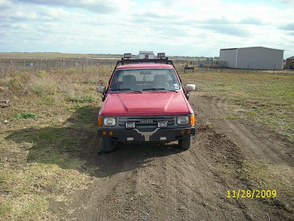

Hey do you happen to have more pictures of that rig? I think it's the only one I've ever seen that is 4 on the floor with a 22re, I thought they were all five speeds or autos. The avatar makes it look like a bad @$$ farm truck.

here are a few more pics
Attached Thumbnails need help making custom cold air intake for 93 22re-dsci0059.jpg   need help making custom cold air intake for 93 22re-dsci0060.jpg   need help making custom cold air intake for 93 22re-dsci0062.jpg
